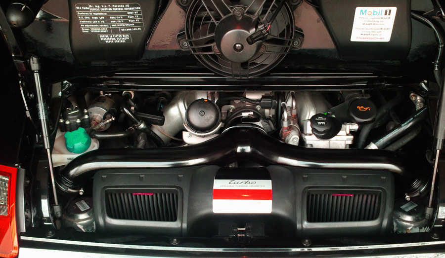

On the Y/Boost Pipe...I took it off and sanded the surface so it was smooth, and then hit is with PAP (Plastic adhesion promoter) spray, then primer, sanded again, then sprayed Basalt Black Metallic, then a few coats of Clear, and set it front of a heater in my garage attic for a while....And it has held up very well. Also put body stripes on the air-box, and when you have the lid open you see the effect...The red lines up with the tails and the black with the rest and has a nice look...
You can get the paint and clear etc. in aerosol cans ( I have a gun...but a pain to clean for small jobs) from Automotive Touch Up Paint online (Out of New Orleans) and it matches pretty well. About $19 for a can of color which is all you need and about $7-10 for the clear and PAP etc..

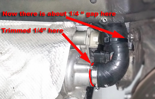

Here is an updated photo. Trimmed off 1/4" at the turbo end and pushed it on very hard while tightening. It went from being pressed against the bracket, to having about 1/4" gap, so should be all good now. Did the same on the other side as well.
DC

Looks perfect. Nice work. Did you use a razor or something else.

Hi there....
I actually used a very sharp Knife as I needed a longer blade. I took the hose off of the fitting that mounts to the turbo and then measured from the edge to about 1/4" and used the band clamp as a guide to draw a line with a Sharpie...Then I put the band clamp on the end of the hose and slid it back on up to the line I drew so I would know where the edge fitting was...Clamped it snug and poked a hole as indicated and then slid the knife through it from top to bottom. Not a perfect cut, but clean enough! Hope that helps. Pic below.
Note in the picture it is already cut and installed...just showing how I cut with the blade...If you cut that much off you will be in trouble!
