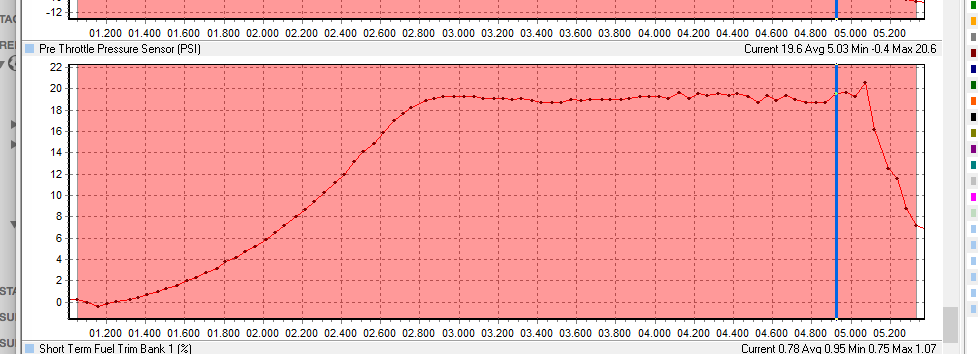

Originally Posted by prodigymb
why did you back it down to 20 psi on pump ?
Just went over the logs from the runs and they're actually in the 19psi range currently.
Reason I backed down was limited time on the dyno Saturday to tinker but mainly because torque was already too high in the 4k range. 624wtq on this dyno is 740wtq on a Dynojet which by many has been stated to be stock rods limit. We'll be keeping low end boost in check to keep the rods happy as mentioned before but tapering boost up towards redline to flatten the torque curve and see what it can do.
