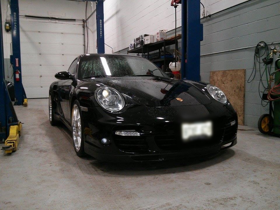

She's back and mighty clean
One step colder plugs introduced with a shorter gap than OEM. Fresh pair of Beru 997 coils.Thank you @prodigymb for the tip on the plugs. They're a great 1 step colder alternative with a perfect gap for higher boost. We've also got a fresh pair KLINE exhaust manifolds on the car now to compare performance against the OEM that we've been running with thus far.
With meth injection we had ignition break up at around 25psi. Once weather improves we'll take her out to hopefully finalize tuning and see where we stand power wise with this project. It is impossible to put the power down even on wg spring pressure in these temps with R comps

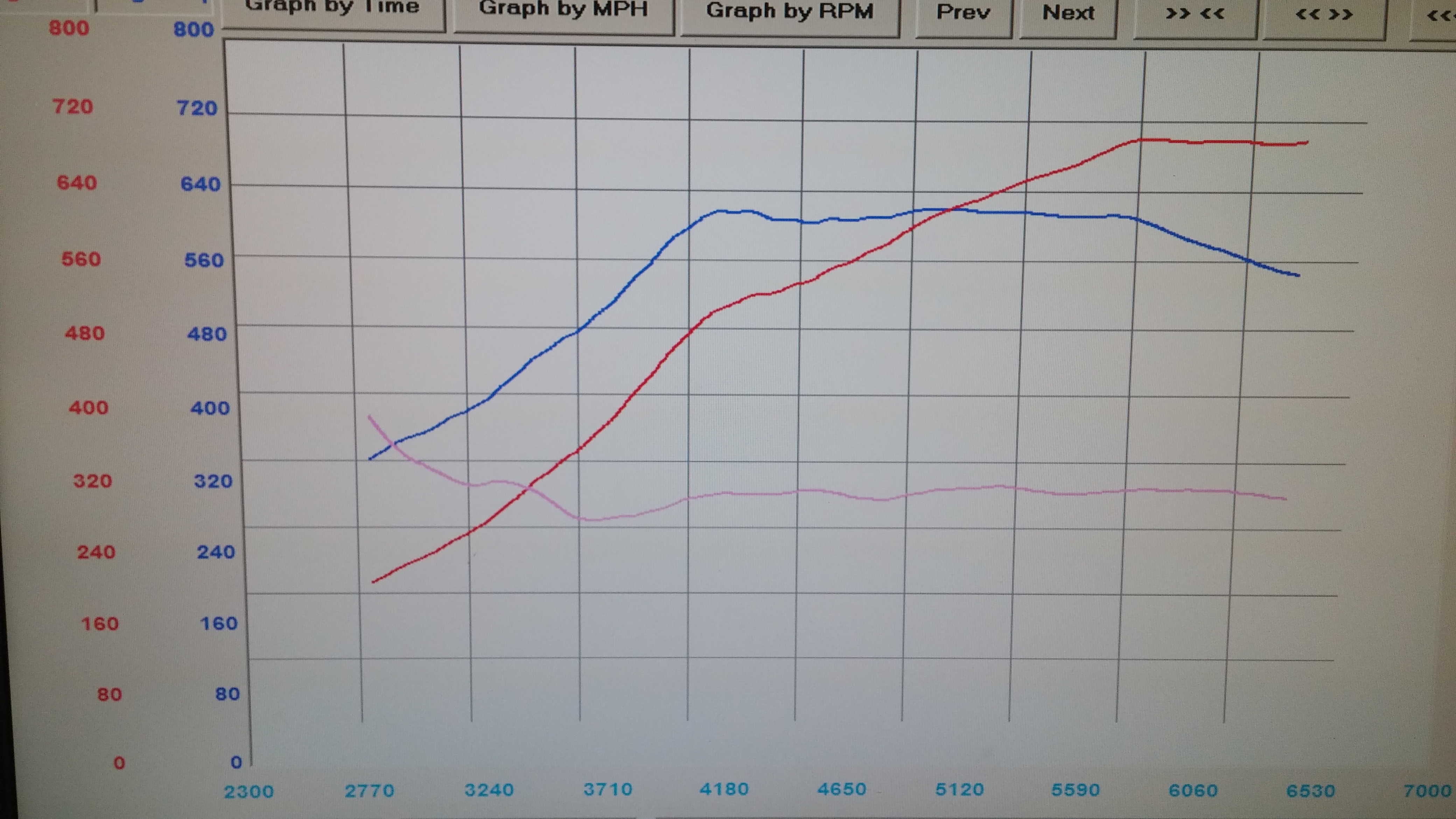

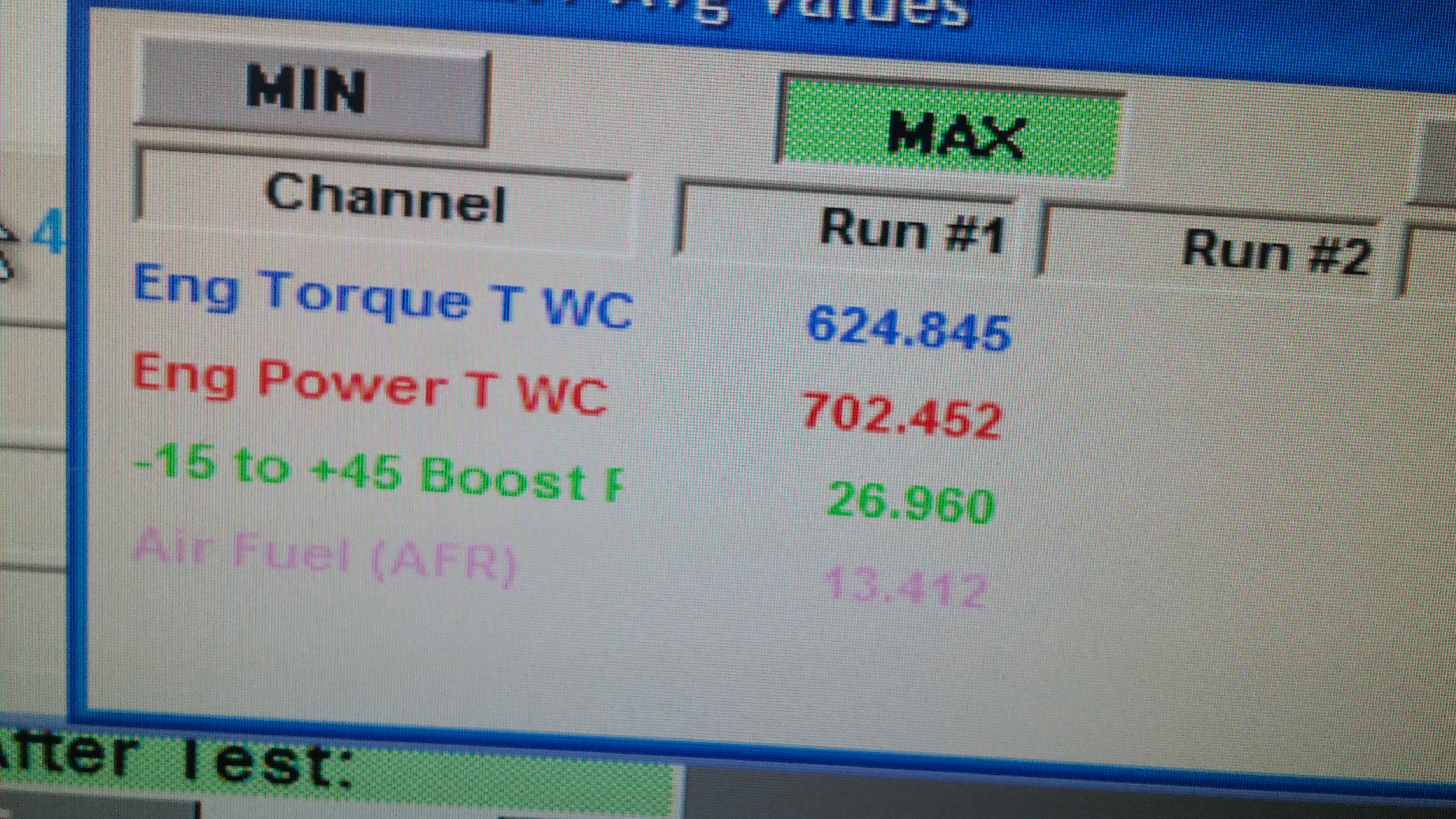

@wolfehedge, here's where we decided to stop for now on pump gas and meth. We're being relatively cautious on the low end torque keeping timing and boost conservative in that area and ramping it up towards redline.
Boost hits around 20psi down low with only about 9.5-10* of timing and ramps from there to about 26psi in the top end with timing again conservatively going to about 17-18* by redline. Lambda is around .77-.78 (11.4-11.5:1) from peak torque to redline without any timing pull/knock across the board. With E85 or race gas in the car I'd be a lot more comfortable to push a little harder with ignition timing and boost but we've got no E85 at the pumps here. C85 from VP is the only kind we've got and we'll see what those numbers will be when we get to build an all out stock motor map on this setup. It'll most likely require larger than ID1000 injectors though as we're currently sitting in the high 70s range duty cycle on them even with meth supplementing some of the fuel.
There's a lot of torque/power in midrange on the table by raising boost and timing in that area but we're really happy with how the car is running at the moment and we're being mindful of the rods. Keep in mind a bone stock 997.1 turbo on our Mustang is in the 380-390awhp/awtq range so use that as your reference.
Car is running Pirelli Trofeo R tires in 235/305 configuration and boost by gear is a great feature to have to put the power down in 1st and 2nd at these torque levels.
We're hoping to have the car on an AWD Dynojet to get those as well. Should be 800+awhp on a Dynojet but we'll see, no richer math
702awhp / 624awtq Mustang AWD Dyno - note the RPM values on the graph are a little offset to the right from the actual graph, run ends in the high 6k range
