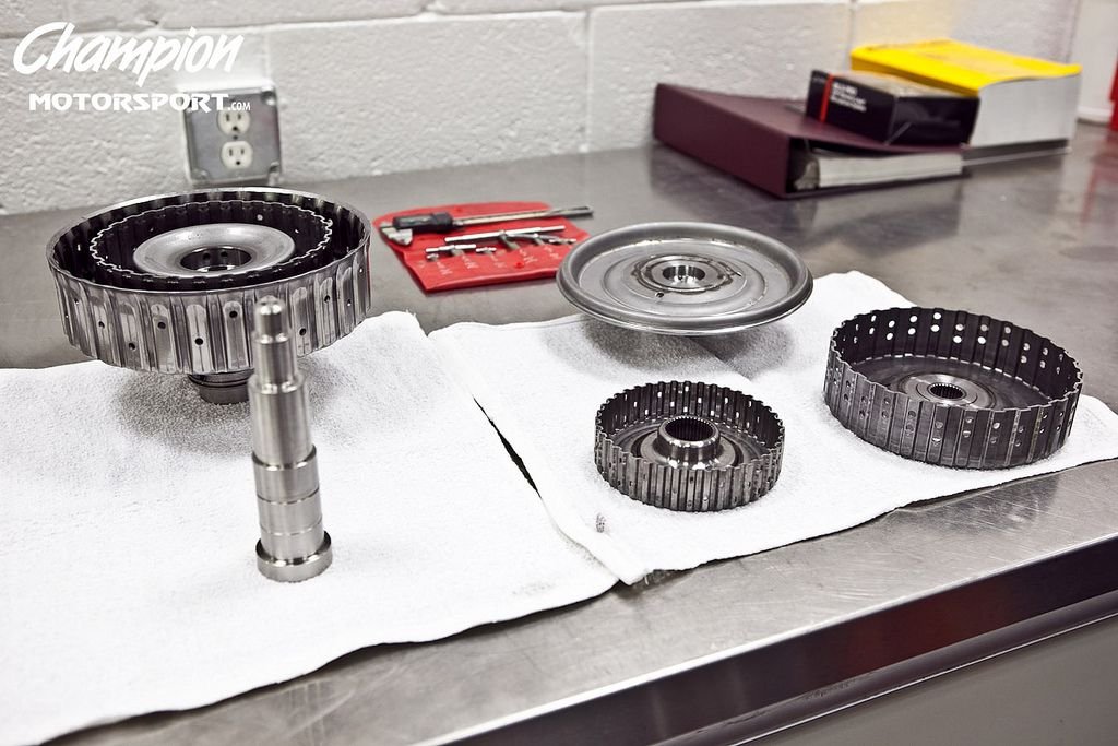

It will most likely be worse. Unlike the GTR, the Porsche PDK is "non-serviceable" which means Porsche never intended for the clutches to see the light of day. In order to change them, you need to basically cut open the transmission. After the new ones are installed, you need a VERY skilled person to weld it back together, to within .001" tolerance of where it was.
Get it wrong, or cause even the slightest damage while you're cutting and welding.....and you just bought a $12k transmission unfortunately.
I'd be interested to see someone install these and push the PDK, then compare it to the levels of power we've seen that the stock clutches are capable of holding.

Are you saying the clutch basket is sealed and non serviceable? Or something else inside the transmission?

Pdk clutches are not serviceable as some stated and welding would be required. It is what it is.
Markski
Something like this?
http://www.sspperformance.com/porsch...ch-basket.html

Originally Posted by rix
Just an FYI...the picture they are using on their website is not of any product they're developing. It's actually just a cropped version of a picture they stole from our Flickr page.
https://www.flickr.com/photos/champi...7624484124039/
Here's the original...
That's funny. I wasn't endorsing them as a vendor, but more for what they (appeared) to have laid out on the table.
