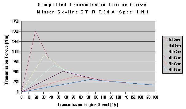

Longboarder, not to highjack this thread but what's your experience with the shift points while drag racing? I've been shifting right before redline but have been reading some articles which recommend shifting where the torque curves cross each other (when comparing the tq curve between gears). See the diagram below from a skyline, the optimum shift points aren't always at redline so I'm wondering if there's more time to be had from my shiftpoints? Engine mods without a corresponding gear ratio change are one reason for shifting prior to redline. I haven't had a chance to experiment at the track. Thoughts?
Here's a link to one of the articles for reference: http://www.welltall.com/ymc/discovery/car/shiftpt.html

For airstrip racing I have asked questions on the topic. Where to shift depends on your powerband. The best bet is getting a dyno to study to torque/power curve. For cars that make tons of torque mid-range but then falls off a cliff, so to speak, one would need to shift prior to redline/fuel cut.

This is definitely THE best way of finding the optimum shift points for any car.
