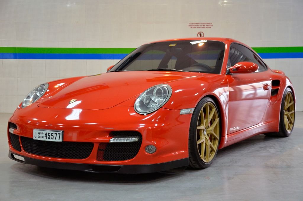

ET18 is way to crazy to look good. On a 997 widebody, the max without sticking out the rear fender arch for:
11" is ET35 with 305 tire
12" is ET48 with 325 tire

I think that you are stuck with the 305 for the 12". On the pic that i posted, the GT2 has 325 on 12" and it looks too square to avoid rubbing issues witb the ET31.
