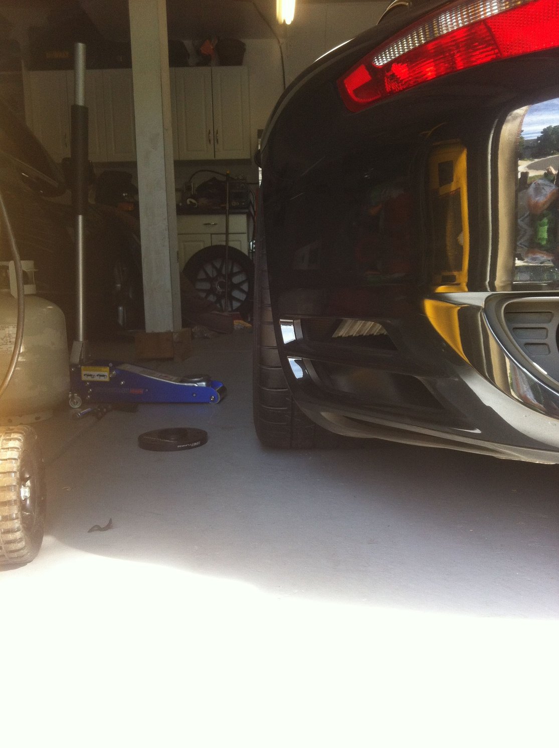

Do you have pictures of your set up with 18mm on your car?
The reason I am asking is I currently have 15mm on, but have 20mm waiting to put on in the spring.
I have seen the H&R 17mm and it looked like it can still come out some, so that is why I pulled the trigger on 20mm, but was wondering about rubbing as well (I am lowered on H&R's as well).
Thanks
Bobby Ali
Thanks
Bobby Ali
ba
Hey Bobby,
Here are a few. Also, the tires mounted are Super Sports which are much wider (tire to Road) than most. I am running a Chamber of-2°31' I don't think I could run a 20mm spacer on my setup.
