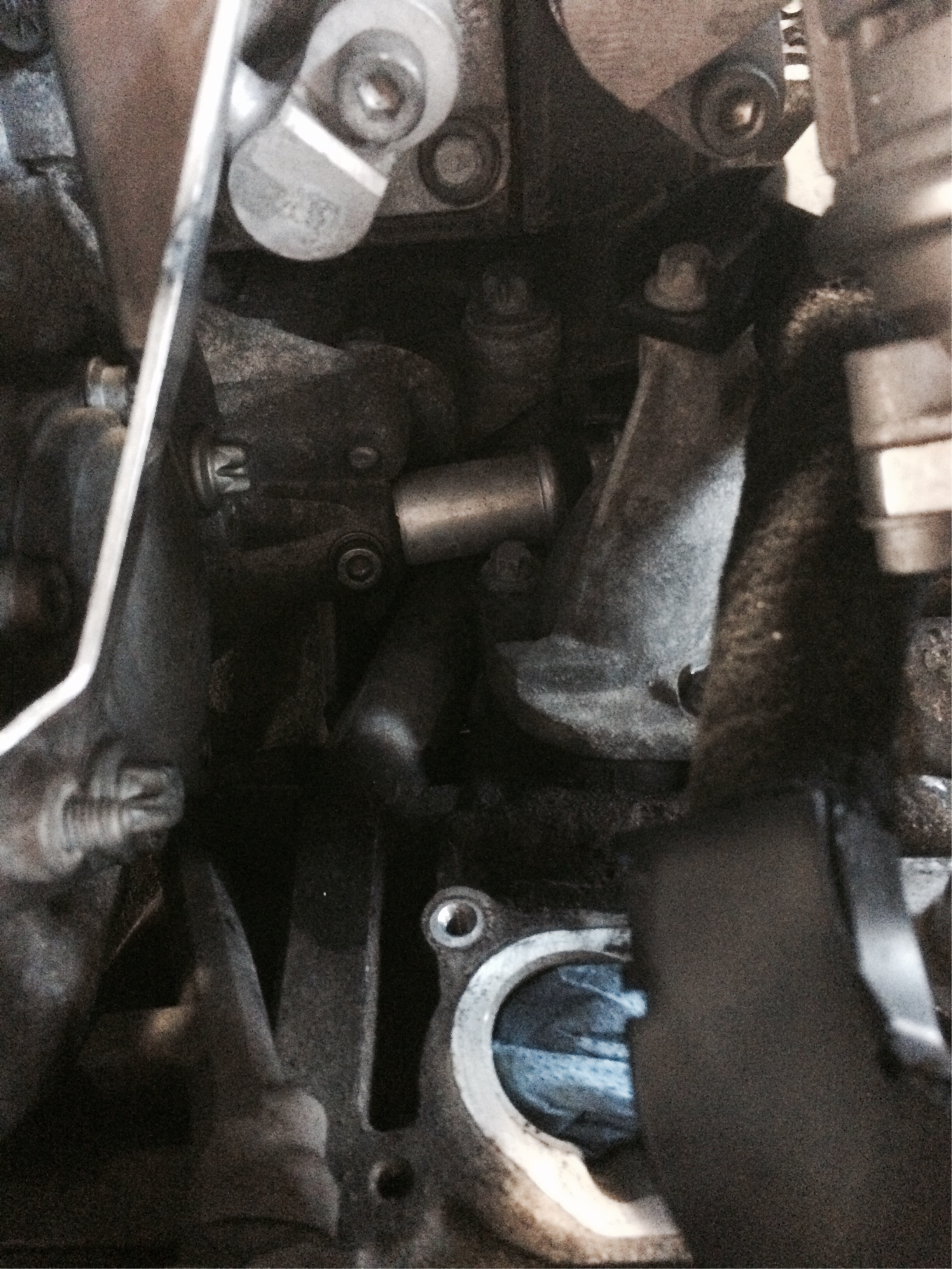

My engine is out to sort what I have since discovered is all three plastic elbows leaking to a certain degree, along with the pinning of the metal pipes.
I've read endlessly on the pipes needing to be sorted, and seen reference of there being 7 metal pipes (plus the three plastic elbows) that need fastening by either pinning or welding, but I can't find the seventh pipe. Can someone kindly point it out to me?
Plastic elbows:
Three plastic elbows to be replaced with Sharkwerks alternatives
Smaller casing:
Three pipes off the smaller casing near the turbo water pump
Larger casing:
Three pipes off the casing near the main water pump

Does anyone have any info on the 7th pipe that needs pinning? Have poured over the Sharkwerks site and all the forum posts, and can still only find 6.

I had 7 welded. Sorry for the bad photos but, hopefully they help.

Thanks, that helped. I think the one I was unsure about is in your second photo. It's on the right side, to right and below the oil filter. It can be pinned while installed.
