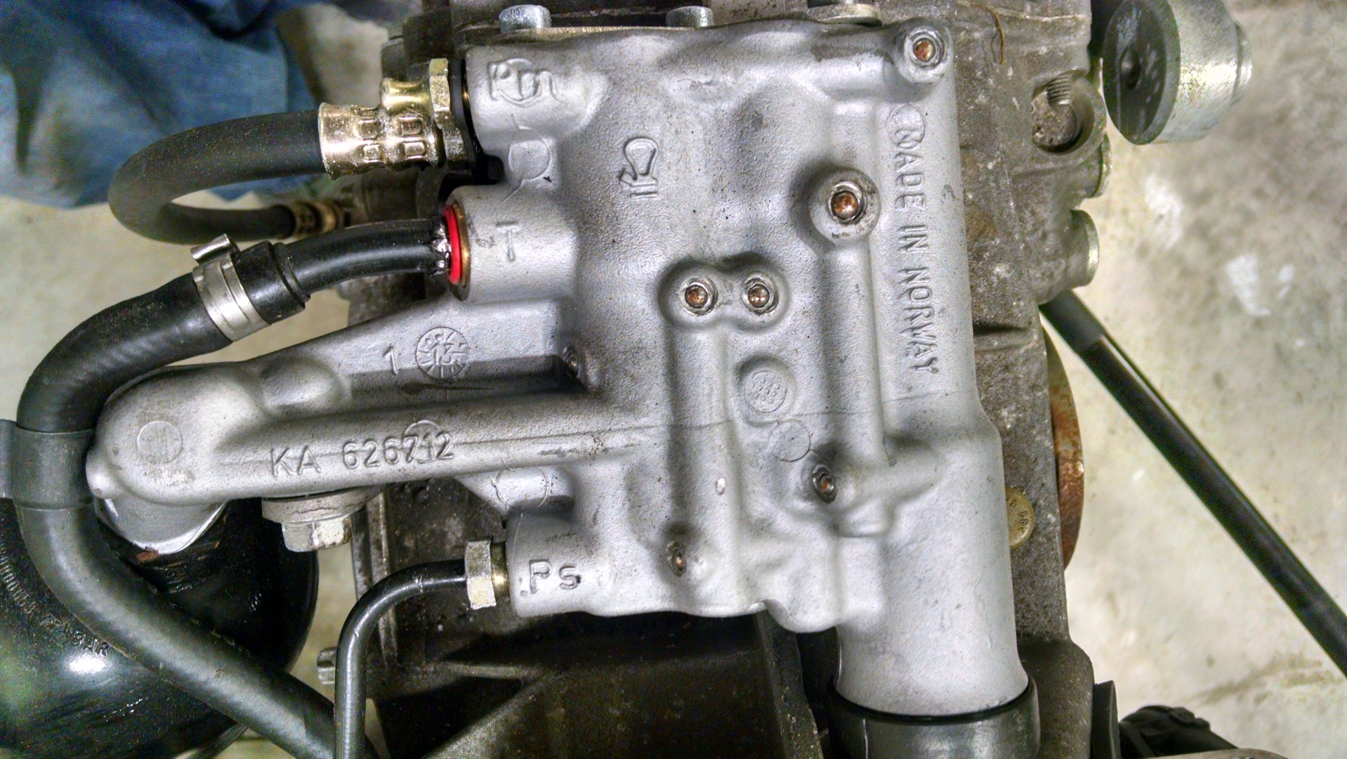

Question:
The motor has obviously been out before, and the slave replaced. Not sure what I am looking at.. The casting number does not seem to correlate to any porsche PN.
Just wondering if it is stock or not. The clutch is fairly grabby, so I am guessing it is aftermarket. Hoping it is, heh.

That is the stock slave cyl/accumulator nothing aftermarket there unfortunately.
Yea i figured. It was replaced, so hopefully the clutch is aftermarket

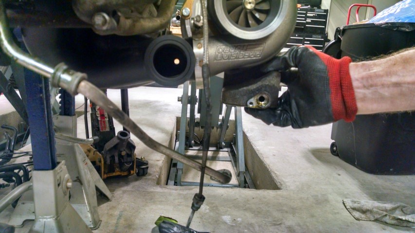

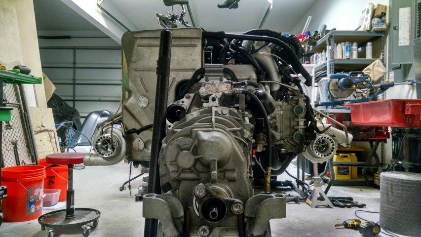

Turbos bolted up.
Plan to machine the stock oil tanks and build lines this week, get them installed and the motor back in next weekend. Then I have to start fabbing intake tubing (pressure and inlet sides) and exhaust.
Inlet side is going to be a PITA, I can tell.
Thinking about going ahead and installing a flex fuel sensor.. looks like I could simply put it between the main feed and the rail easily.. but will this cause a flow issue? Never used one.. If I was building a fuel system from scratch I would plumb it into the return.

That turbo looks huge!
Old Mar 9, 2015 | 08:28 AM
Joined: Dec 2009
Posts: 6,584
From: S.Plainfield, NJ
Rep Power: 856
Precisions look mean !

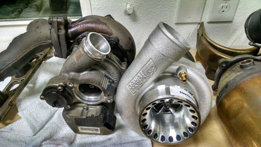

Old Mar 9, 2015 | 07:19 PM
HIX's Avatar
HIX
Joined: Feb 2010
Posts: 983
From: New Smyrna Beach, FL
Rep Power: 120
HIX Is a GOD !HIX Is a GOD !HIX Is a GOD !HIX Is a GOD !HIX Is a GOD !HIX Is a GOD !HIX Is a GOD !HIX Is a GOD !HIX Is a GOD !HIX Is a GOD !HIX Is a GOD !
Pardon the retarded question, but how do those Precision's spool compared to the VTG's? Looks HUGE compared to stock turbo.

jordonmusser's Avatar
Joined: May 2012
Posts: 677
From: Coppell, TX USA
Rep Power: 113
jordonmusser Is a GOD !jordonmusser Is a GOD !jordonmusser Is a GOD !jordonmusser Is a GOD !jordonmusser Is a GOD !jordonmusser Is a GOD !jordonmusser Is a GOD !jordonmusser Is a GOD !jordonmusser Is a GOD !jordonmusser Is a GOD !jordonmusser Is a GOD !
No where near as quickly.. we'll find out here in a few weeks.
Give and take.. more efficient at the top end means boost comes on at a higher RPM.
My last boosted car was a 7.0 Liter Z06, I am guessing the boost will come on slower
