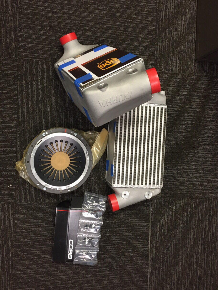

Ran the car today still with 102 octane fuel, and retuned the car back to its base map. The car hardly pulled any timing at all (-2.5) for just a few seconds nothing major at all. It's this sort of timing I would expect it to pull of any at all. It's my opinion in conjunction with Jon that there are no real mechanical issues at play.
I have sent all my maps to Jon at his request for review. I'm sure there is just something minor my car doesn't like.
I have a bunch of goodies that are piling up in my office that I'd like to get on the car...
