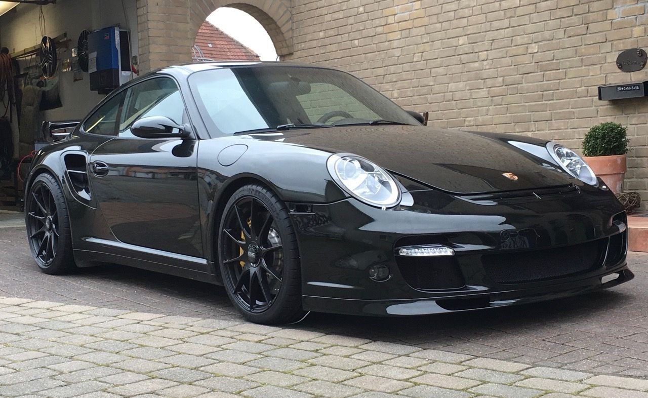

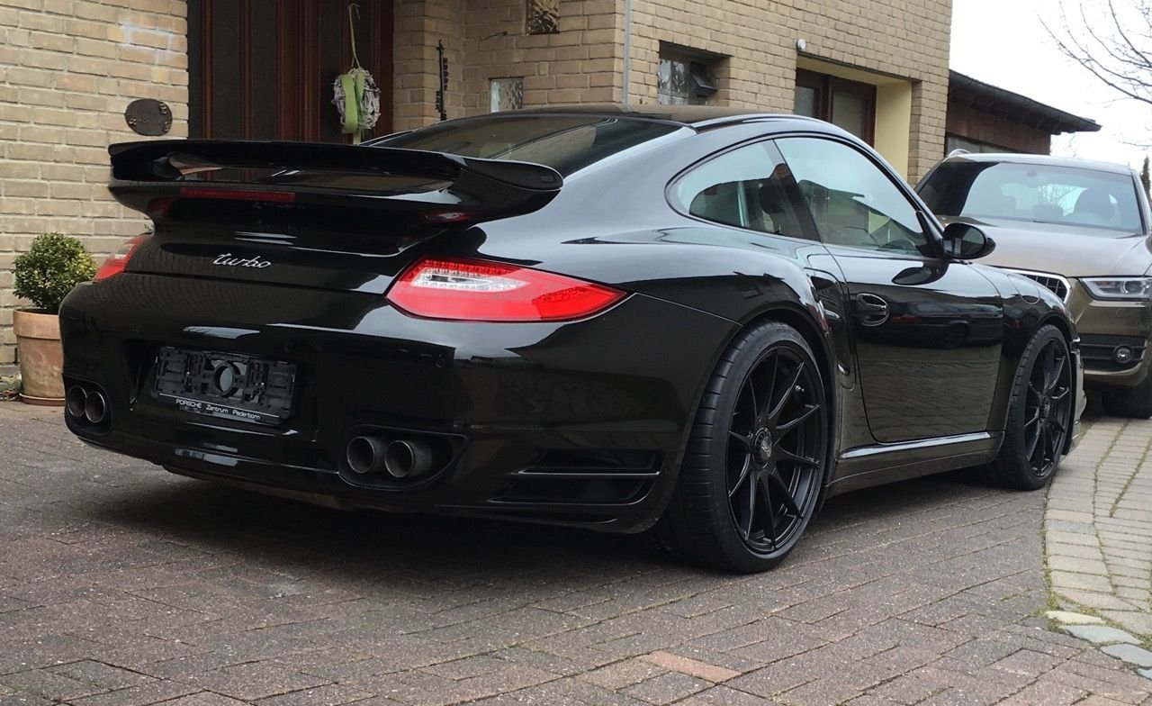

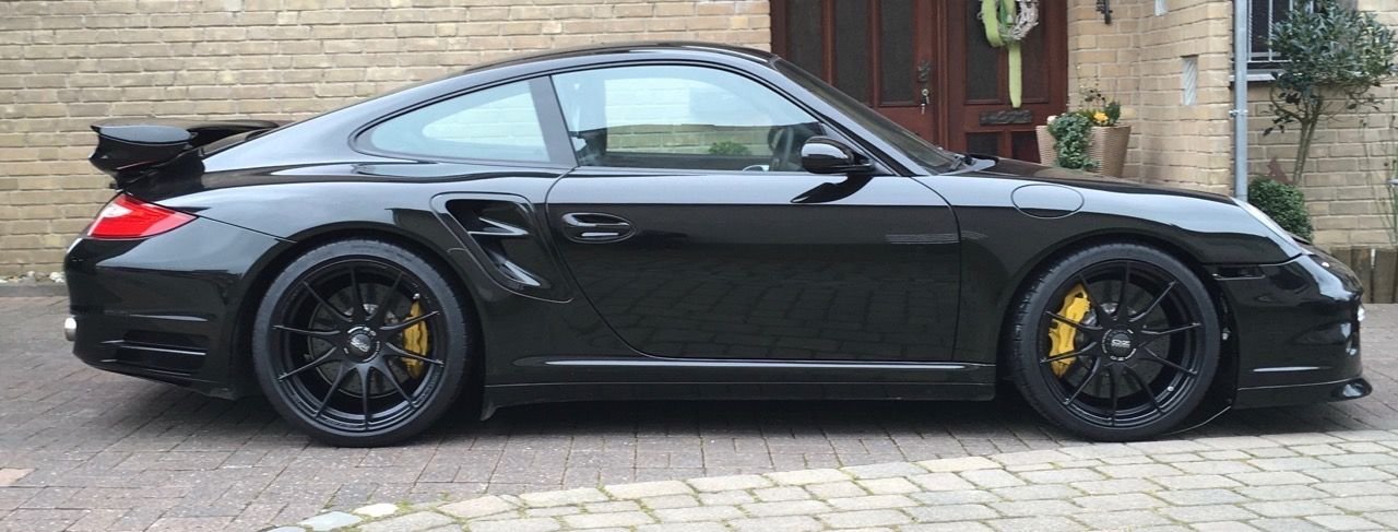

Finally, i made it. Some parts are missing, like the gt2 side skills and the techart diffusor,which are with my painter. But i received my new OZ Formula 19'' with Michelin Pilot supersport. I have to change the wheelplates at backwards wheels. But I will finished him within the next 2 weeks.
