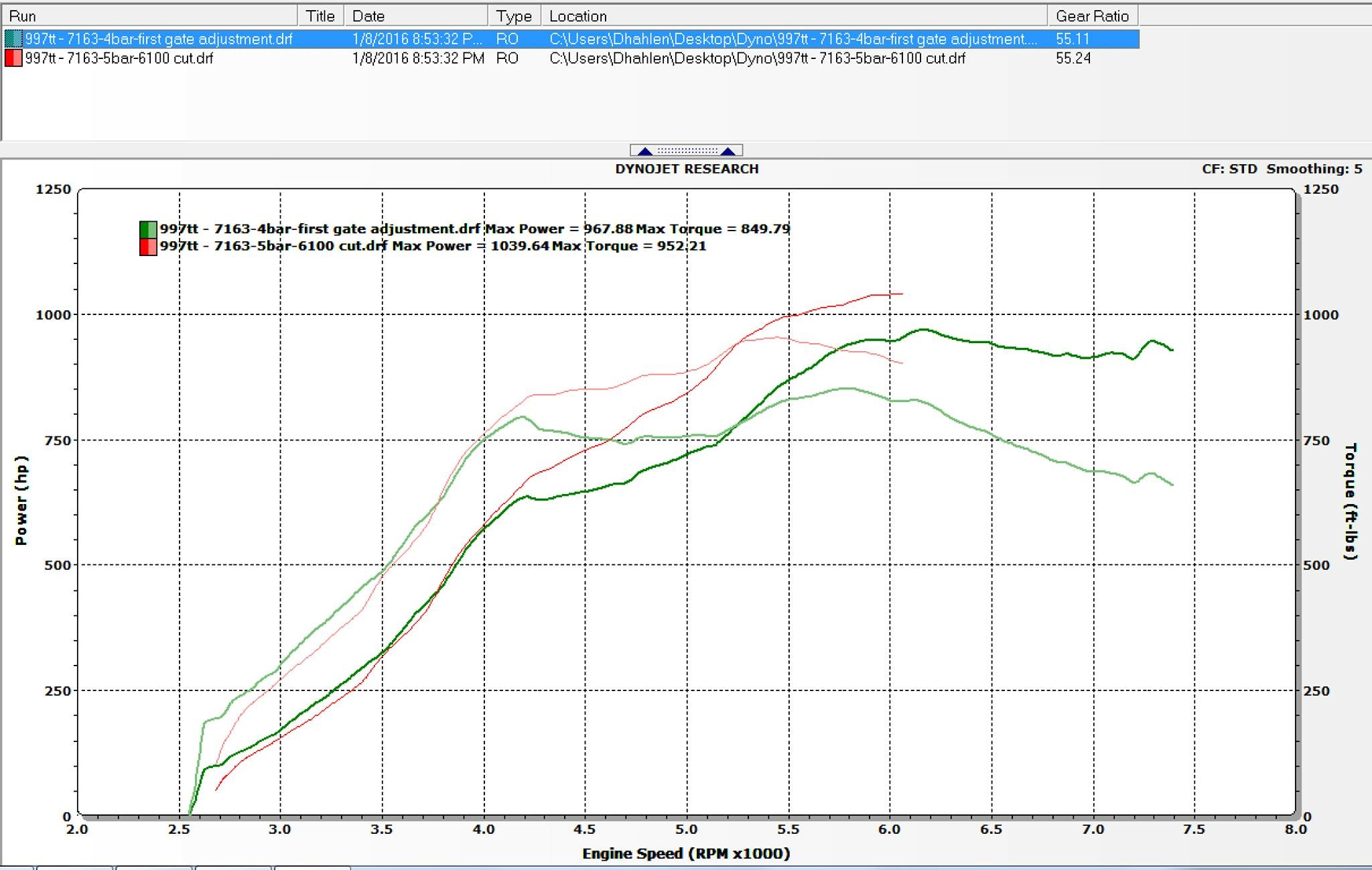

Originally Posted by Obb
Who cares about pulling all the way to redline, dyno is just a dyno we all know more is coming soon. If you don't mind I would love to see it.
You are doing this on the stock cylinder head and valvetrain or was some work done there as well?
Will need to make some adjustments to fix that dip in the mid range, but here it is.
Stock valve train, I plan to do springs when I do cams just for safety.

Originally Posted by bchjkui
The results you posted were with pump gas?
E7x
Pump gas around 700whp

Found the limits of these turbos, finally
My max power on a mustang dyno was previously 867. I was able to pull a 1007awhp on a Mustang. Will schedule some time for the dynojet run, but I have a feeling it'll be close to 1100.
We were running 30psi on the Mustang dyno and adjusted the gates to allow more flow. At 32psi, we saw an increase in back pressure from 1.3 to 1.7 and were not making any more power. On the street, this is actually about 35psi, according to my logs.
The car rips. More to come soon!

Rep Power: 166
dhahlen Is a GOD !dhahlen Is a GOD !dhahlen Is a GOD !dhahlen Is a GOD !dhahlen Is a GOD !dhahlen Is a GOD !dhahlen Is a GOD !dhahlen Is a GOD !dhahlen Is a GOD !dhahlen Is a GOD !dhahlen Is a GOD !
Dual ports are used for resolution. 25psi for pump and 35 for e85. I could have ran 35 on original gates, but wouldn't have helped my pump map!
