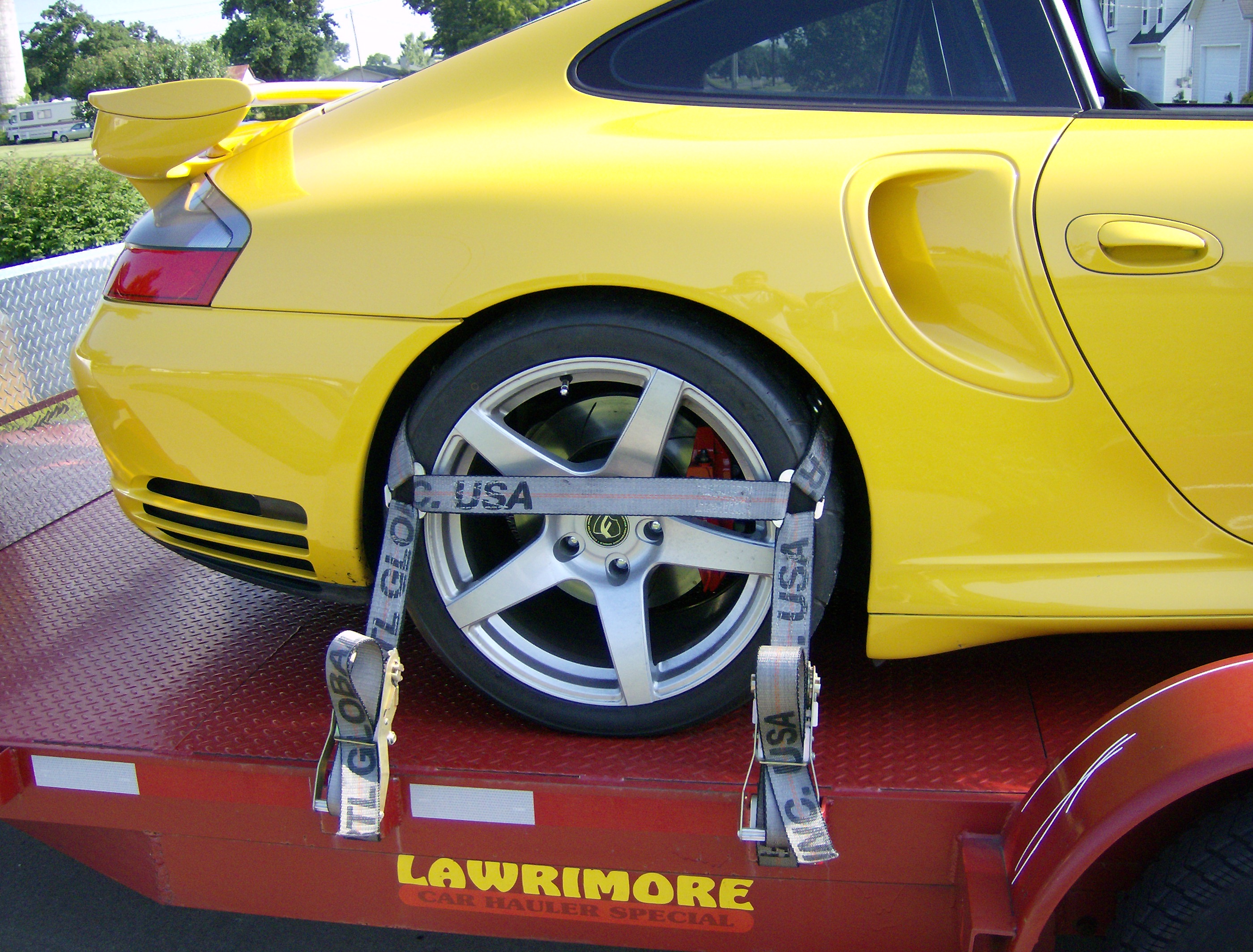

Likely for these cars (being so low), is to use the over tire ratcheting straps. Won't damage any components, and very secure.
Something like the example shown for reference only.
Good luck.

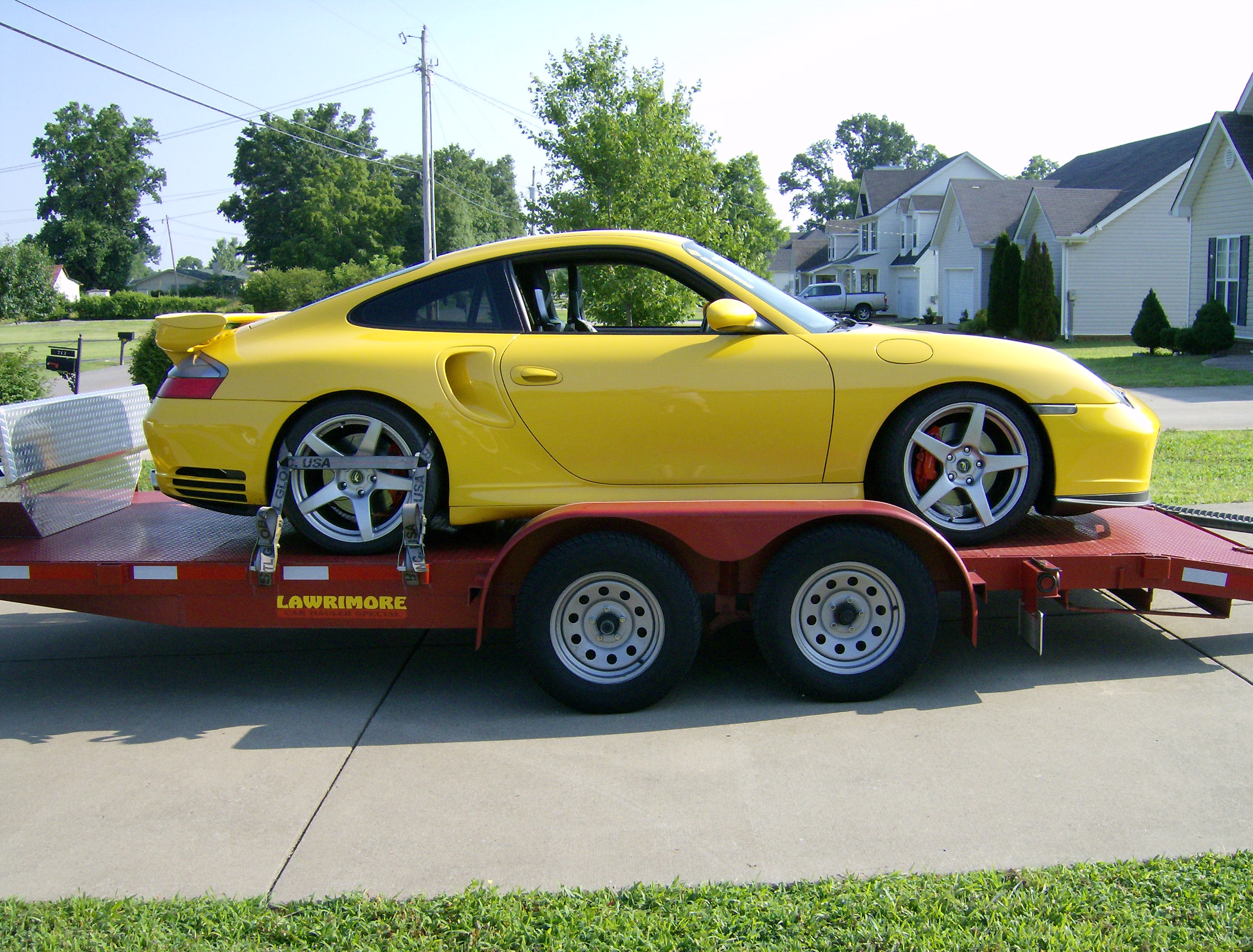

this is how i haul my turbo. i also use the rennline tiedowns since they simply the process a huge amount.
ID:	445308   Click image for larger version
