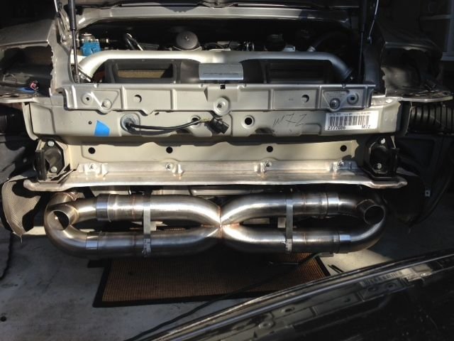

I have a Kline 3" GT2 exhaust with the X and small titanium mufflers. When run with the 100cel cats, it is very mild and quiet. I have switched now to the decat pipes, and it is still nicely muffled, with just the good growls, burbles, and pops coming through. There is some volume at full load, but it is a deep roar, very pleasant. I am very surprised at the moderate sound level. Coming from a Cayman S with longtube headers and race mufflers, this is tame in comparison.

OP good idea on this thread. I currently have a Cargraphics catted exhaust on my 997 and have been tempted to go to a none catted system.
Webspoke, your setup looks really nice.

Looks good, were your cats interchangeable with this setup?
