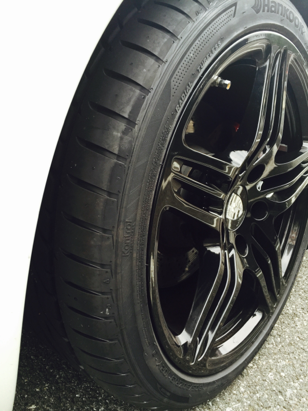

Ok, well here is my honest opinion. I just had to replace my tires after my Michelin Pilot Sports wore similar to yours, the belts were exposed and the tires were just damaged overall. They were definitely vibrating and bumpy but were overdue for a replacement.
After EXTENSIVE research between 6speed/rennlist and independent reviews from friends, I decided to try the Hankook V12 Evo 2. All I can say is given the performance, they may well be the best bang for buck out there. I paid $890 for my tires mounted/balanced/installed. The first 50 - 75 miles are necessary for break in but after that they're absolutely amazing. IMHO they ride great, have minimal road noise and after tossing the car into some corners, I concluded they handle exceptional. I'll give them a 9 out of 10 rating. My brother runs them on his 650 HP ESS VT650 M3 as well and for such a powerful RWD car, it grips wonderfully.
Let me be serious. There is nothing like a Michelin Pilot Super Sport/Sport/Sport Cup. When heated up, they're like glue. I don't know how hard you drive your car or if you track it. If so, maybe you can justify the Michelins. But if you don't and you consider yourself an enthusiastic driver that just drives hard and has fun, the Hankooks are bar none the best value. A set of comparable Michelins will be $1600-1800 and they actually wear quicker from what I've read. My rationale is if I'm basically getting 85-90% of the performance for almost half the price, I'll go with the better value. After the first 100 miles, I put rubbed the tire with my fingers and I could tell they were definitely every bit a performance tire based on the compound.
Now if $$$ wasn't an object I'd go the Michelin's but in my case I'd prefer to use that extra $$$ on other maintenance items for the car to keep her running tip-top. I sure hope this helps.

NY6SPEEDER's Avatar
Joined: Sep 2007
Posts: 397
From: NYC
Rep Power: 46
NY6SPEEDER has much to be proud ofNY6SPEEDER has much to be proud ofNY6SPEEDER has much to be proud ofNY6SPEEDER has much to be proud ofNY6SPEEDER has much to be proud ofNY6SPEEDER has much to be proud ofNY6SPEEDER has much to be proud ofNY6SPEEDER has much to be proud ofNY6SPEEDER has much to be proud of
Sometimes pictures are all a person really needs to be convinced. Seeing really is believing. Hope this helps.
I use Hankook v12s on my Audi RS4 and think they are a great, budget-friendly performance tire. I am not sure they meet all the necessary specs for the 997TT so you might want to double check on that (if those things matter to you).
They do not grip like the PS2/PSS but are much more available and fairly priced (although they used to be considerably cheaper!). One thing to note about these tires it that their shoulders tend to run a bit thin...I run 255s on my Audi and these are slightly, but noticeably "thinner" than PS2s.
Very interesting opinion.
I am on the complete opposite side of the spectrum. I tried them out a couple of years ago in my TT and they were the worst tire I could ever imagine FOR THAT CAR. The tire wall is simply too soft and it flexes too much, especially in the rear of the car.
Keep in mind that I run them on my C63 and they do great on that car - you can definitely tell the tire wall is forgiving, in comparison to Potenza's and even to R888s...and obviously Michelins, but they do quite alright and I don't have any complaints.
I know I am not the exception because when I contacted DTD and explain the situation, they said they had gotten similar feedback and simply asked them to return the tires. They even paid for the freight back and gave me a credit towards a remounting service. I was extremely impressed with their customer service.
I would never run the evo's in my 911...ever again.
