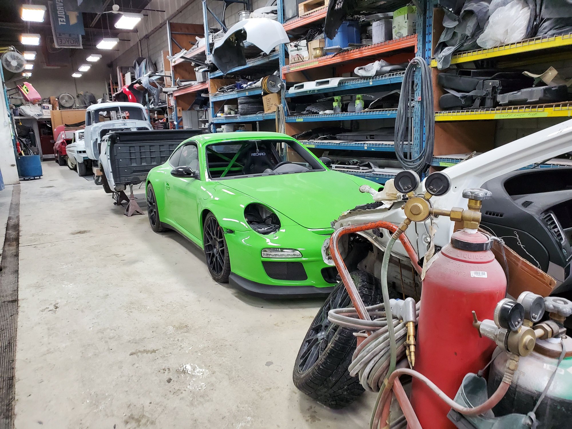

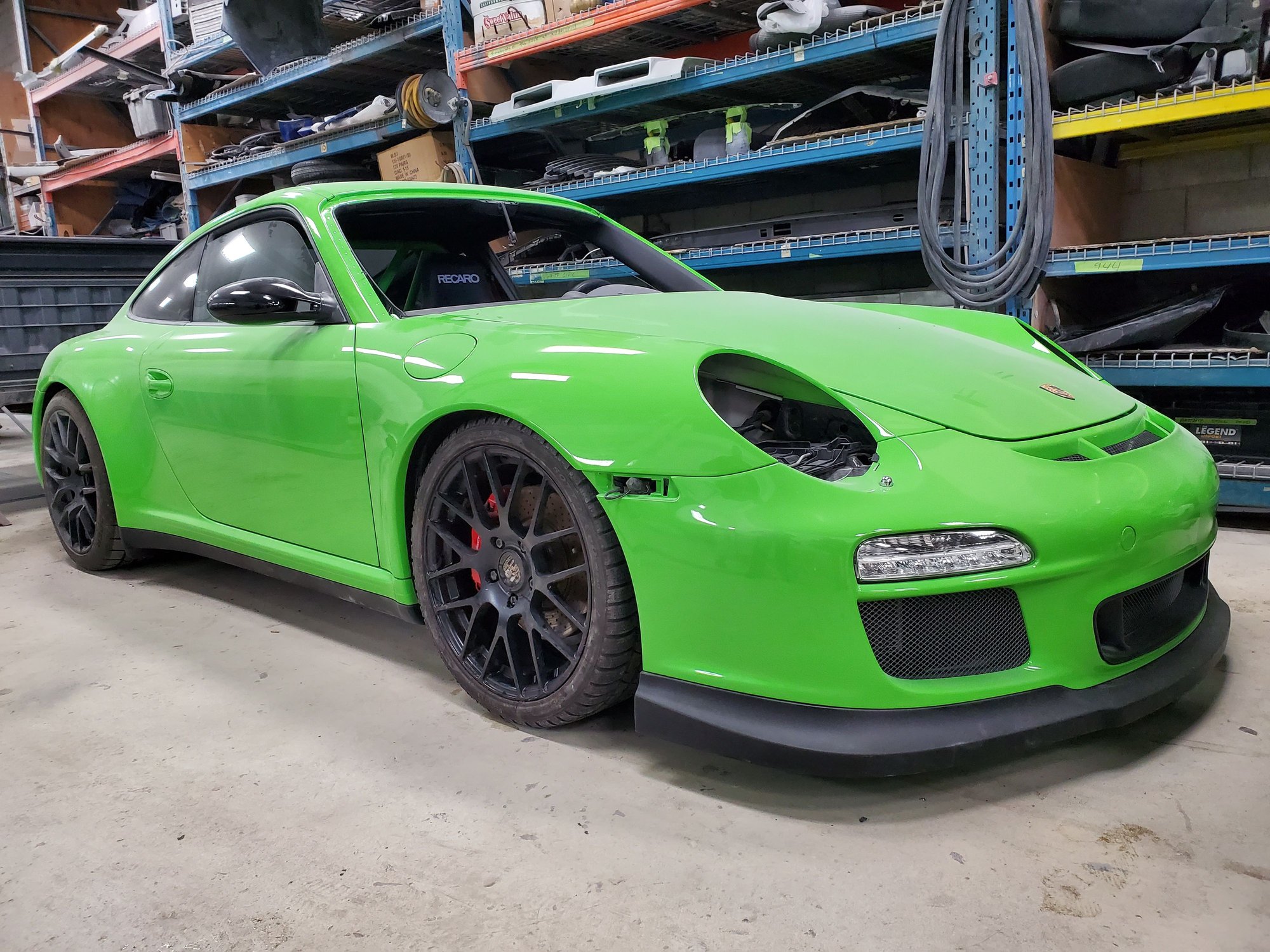

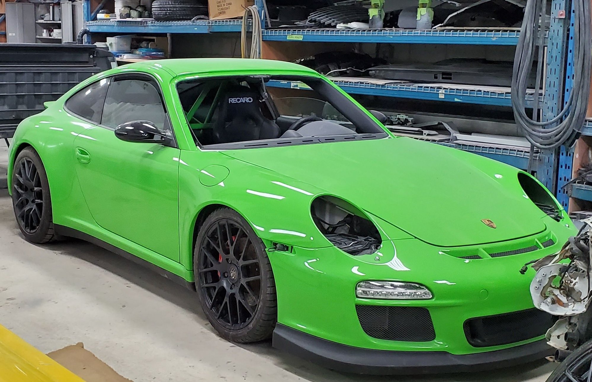

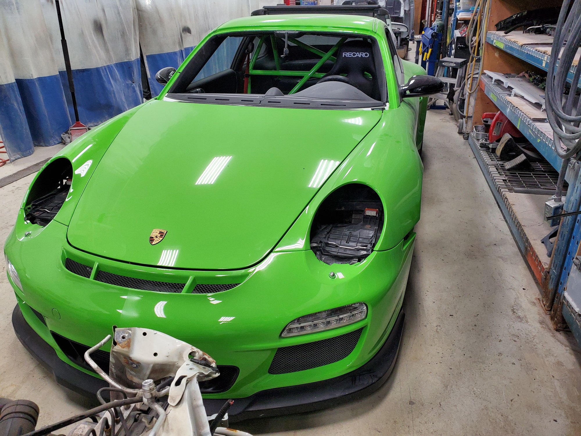

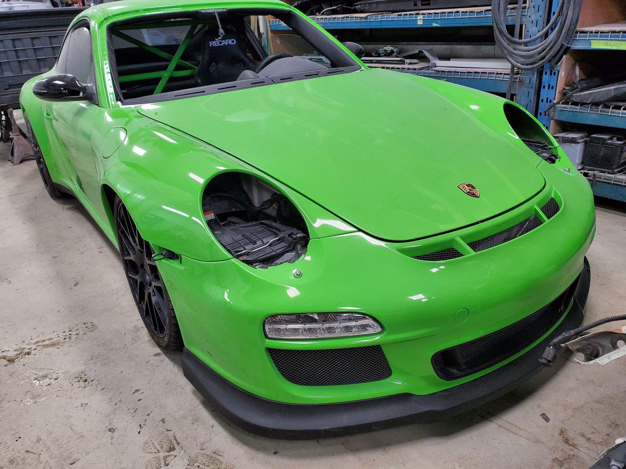

Im running the Cargraphic fenders on my 997, if anyone is still interested in info on them
From some angles, they look no different than stock. But overall, they do give the front end a more aggressive look. Cargraphic says you can run up to a 285/30/19 on a 19x10 et40. I started with a 265/35/19, but the tire was too tall and rubbed. So, will be going down to a 265/30/19 on 19x10 et40.
Currently, I have the winter tires on up front 245/35/19 19x8 et45. You can see how much wider the Cargraphics are over the stock fenders (when my car was white)

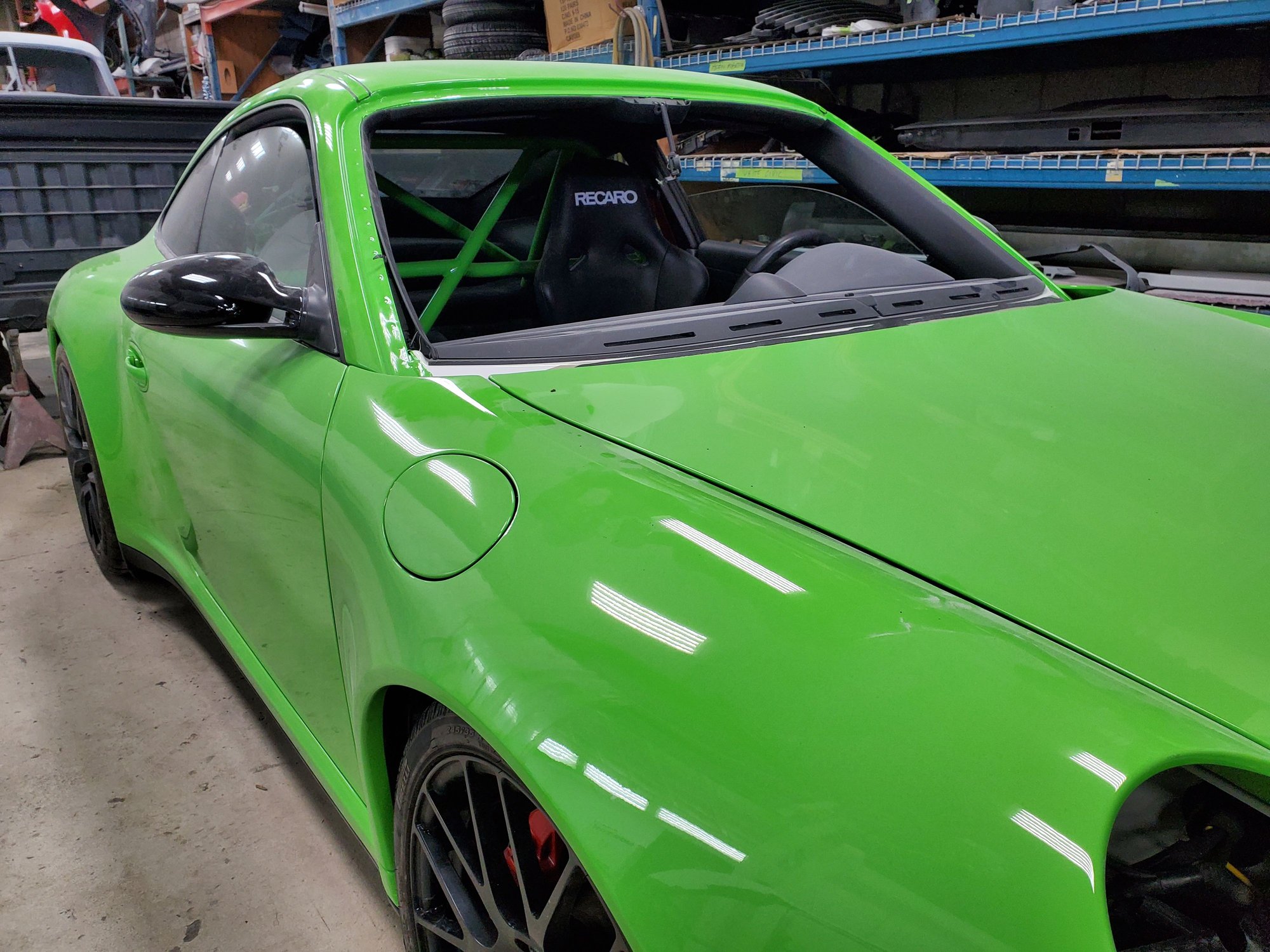

pic below is with a stock 997 turbo front wheel

Will the wide fenders work with the stock 997.2 TT bumper? Ie sit flush at the body panel joint?

They are designed to work with stock front bumper. I am running the 997.2 GT3 OEM front bumper, and the shop got them to line up perfectly.
That being said, I have been told that any of the aftermarket fiberglass and carbon parts require some custom fitment work at the shop when installed, to look perfect. Also, these do not line up with the factory wheel well liner, so custom modified ones have to be fabricated.
