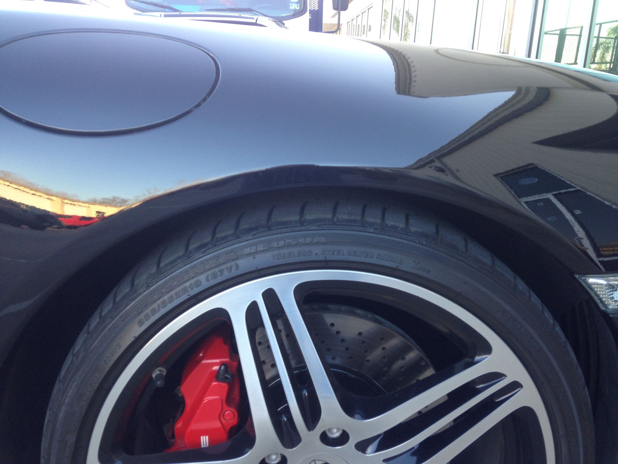

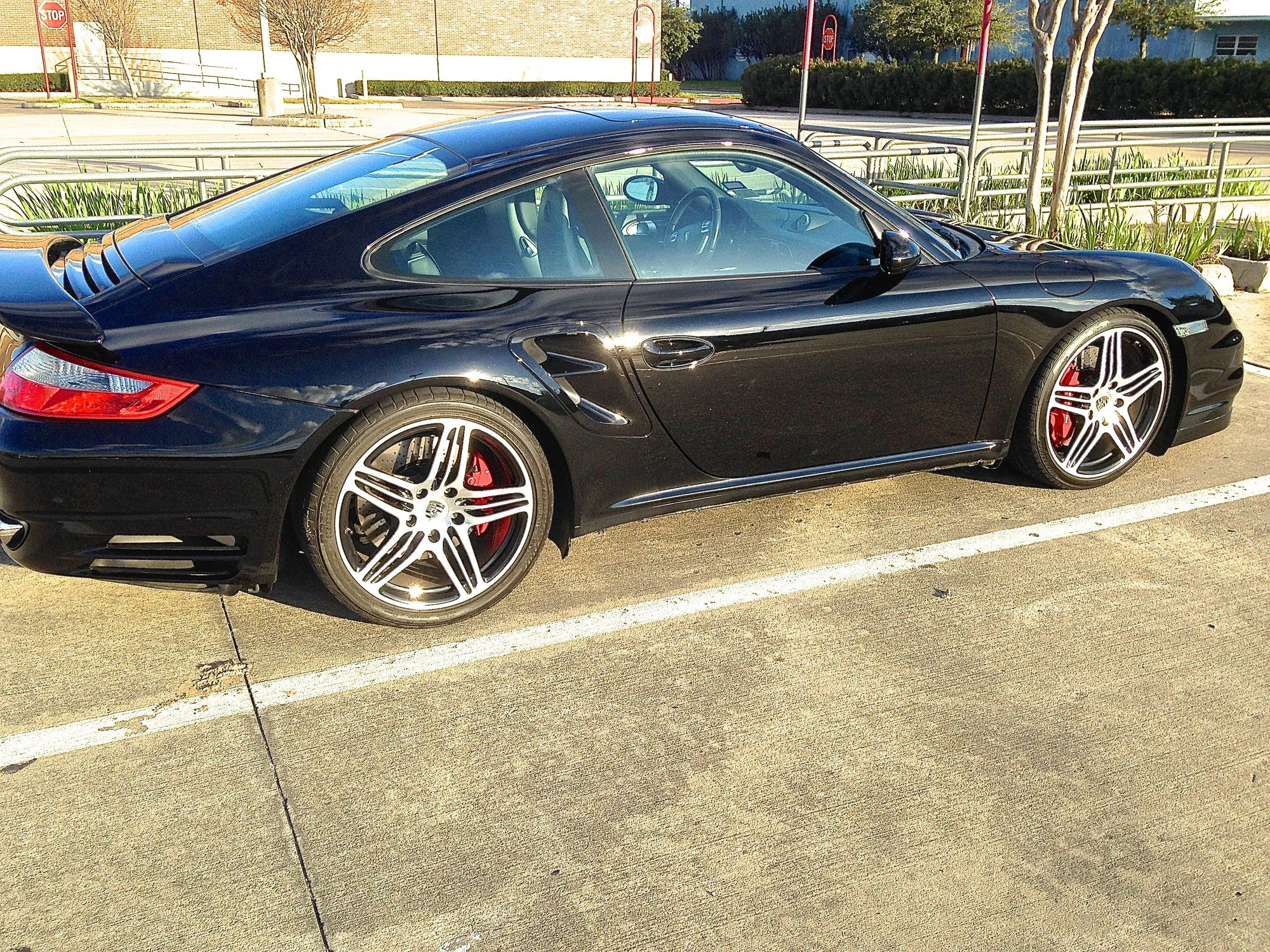

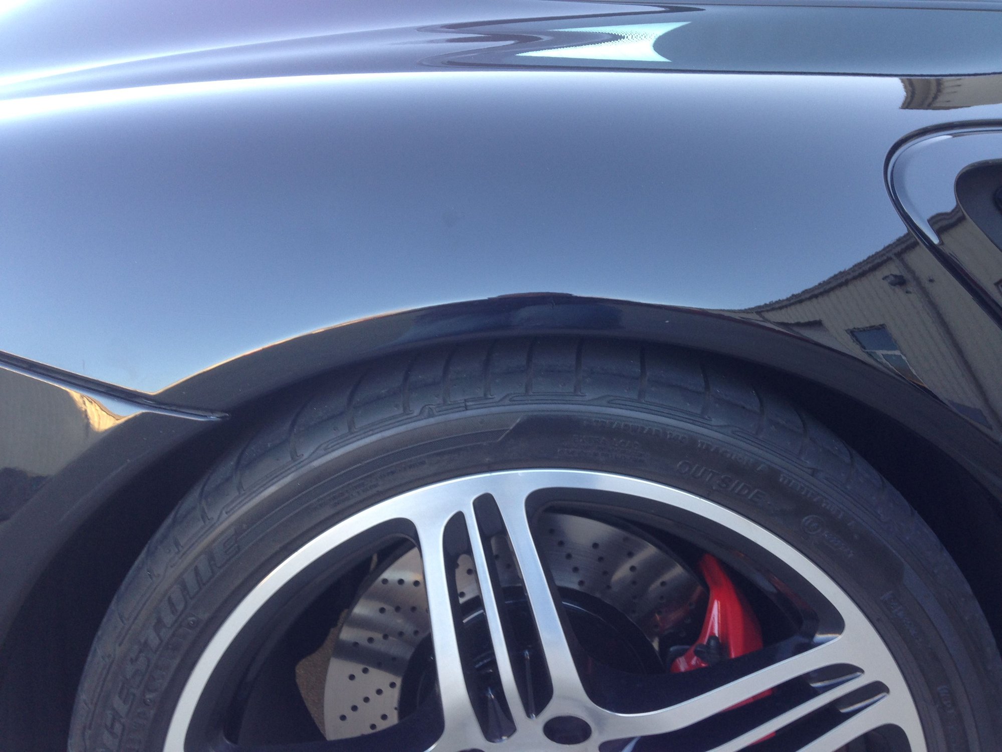

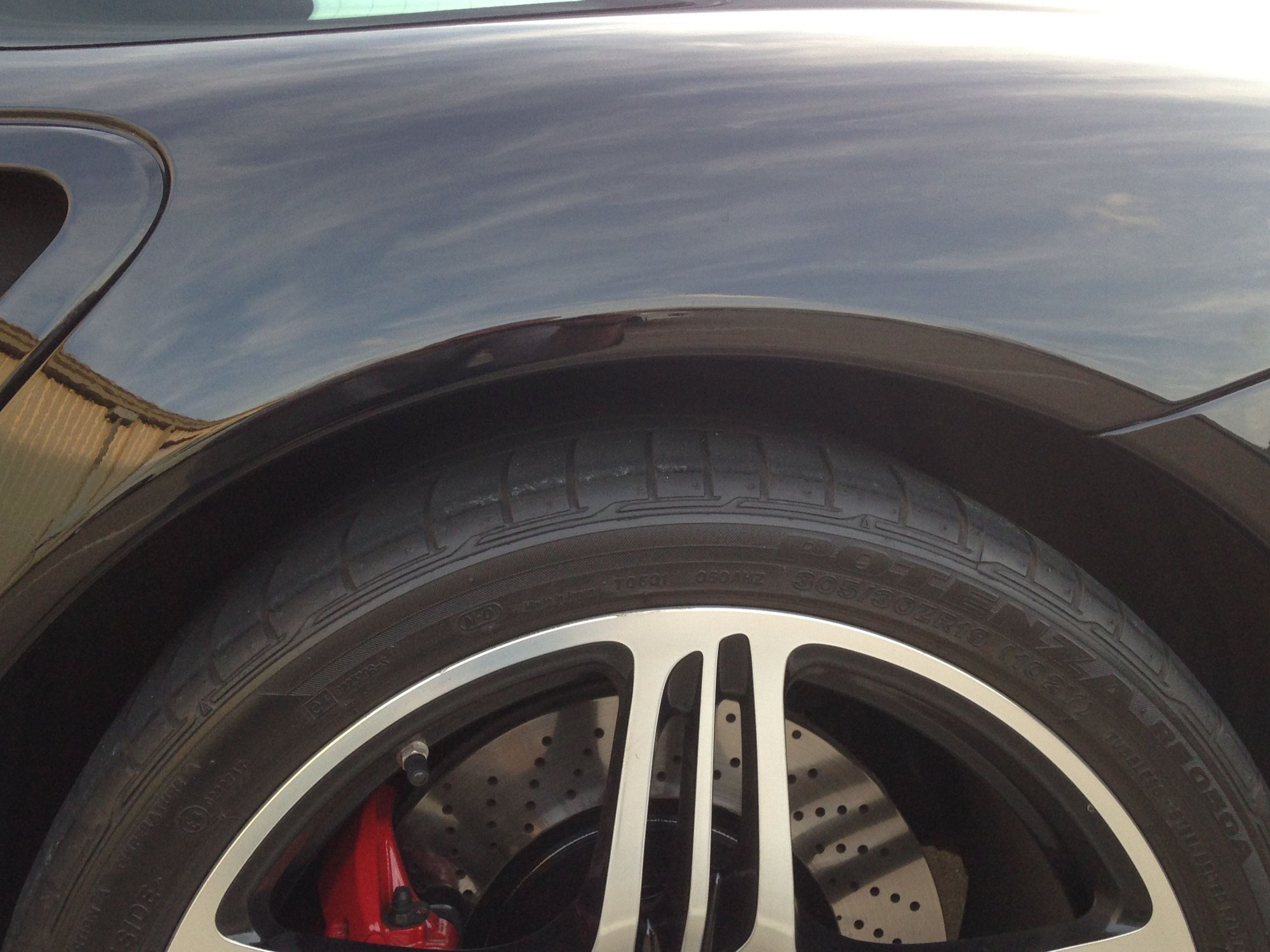

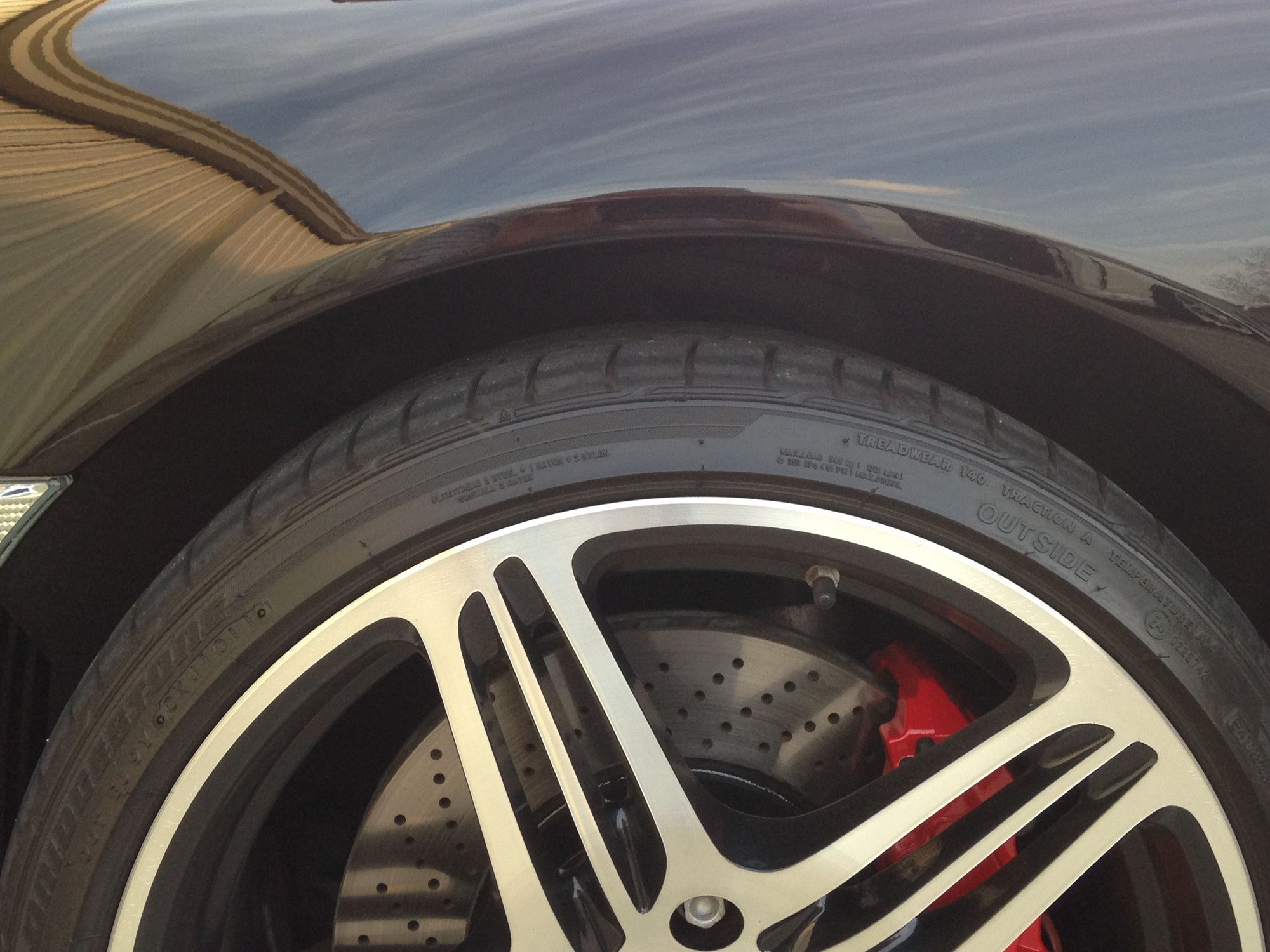

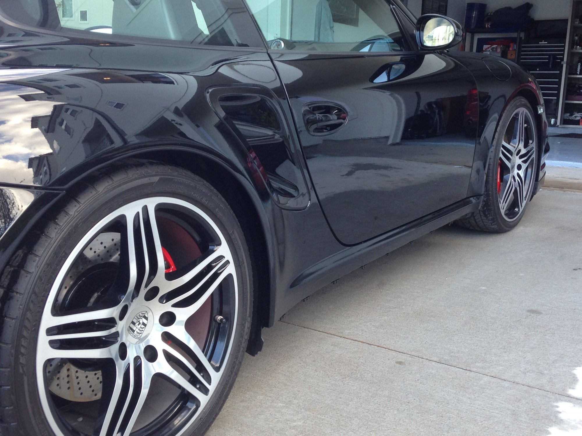

Eibach springs bring the car down to the euro spec and it is perfect for what you are looking for.
A couple old pics to illustrate.
Before:
After:
