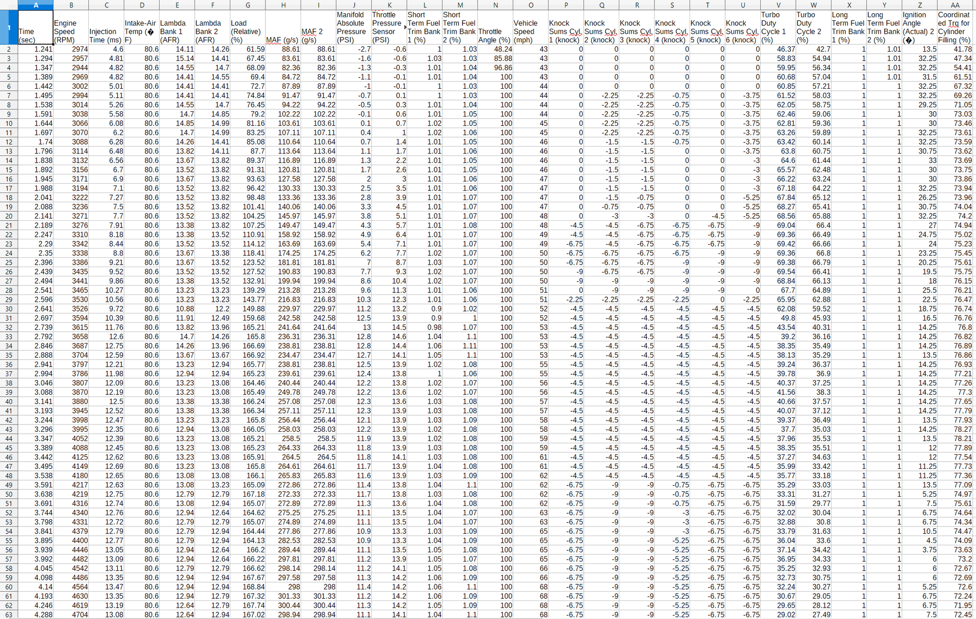

Hoping for some help from this experienced crowd. I recently got an AccessPort for my 997.1tt and am seeing a lot of knock and ignition timing being pulled, even on the stage 0 tune in normal mode. I've replaced plugs and coils, and fuel & air filters are only a few months old. Tried different gas, tried adding an MMT-based octane booster to the gas, tried running with MAF sensors unplugged, checked that FPR line was attached - nothing seems to have an effect. I'll paste a chunk of log below. Could this be O2 sensors? Those are the only thing I can think of that haven't been changed.
What are the other possibilities I haven't thought of? Any further debugging anyone can suggest besides taking it to the dealer and letting them figure it out? Thanks!

From the data nothing really jumps out at me.

Your afrs seem to be fairly lean, target under peak load is usually around 11.5 to 12.
