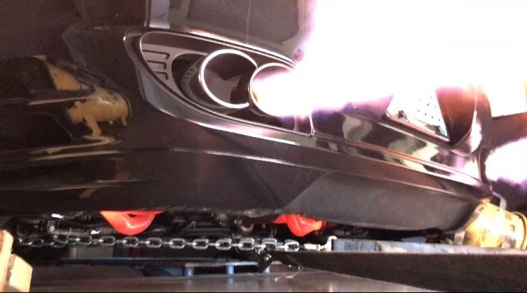

Are those the manifolds glowing under the car?

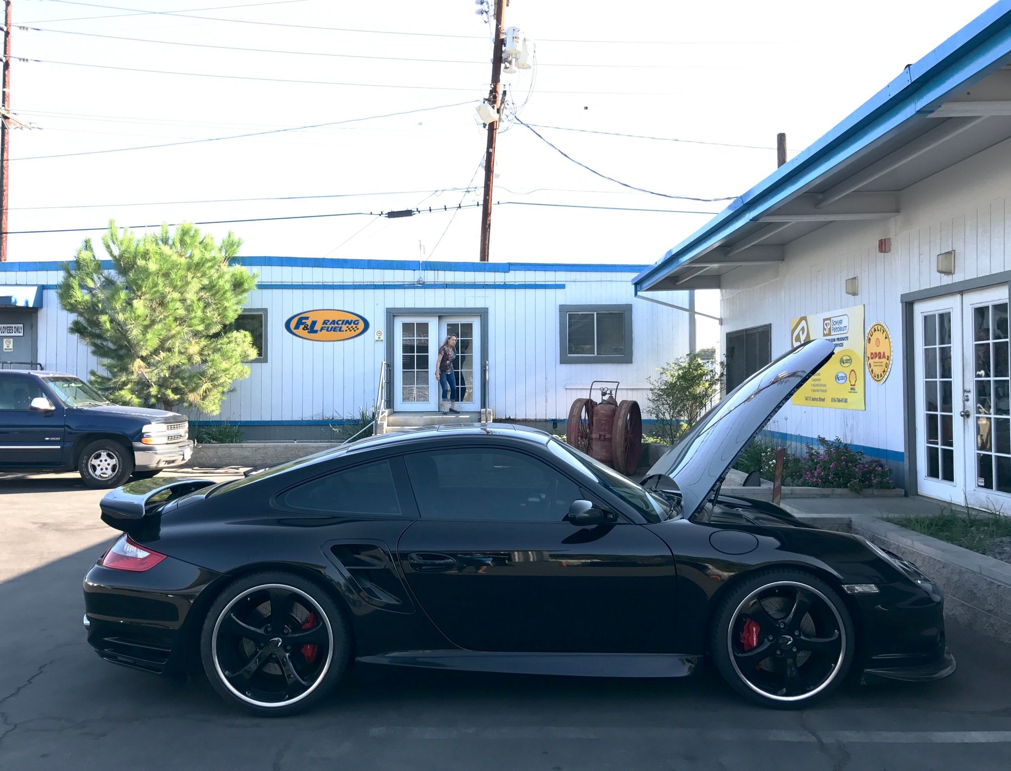

Oh yeah baby. Wait till you see his on ethanol! In J's (02black330ci) thread he's got a great video of them glowing

Cheers buddy I'm really happy with it. Look how we brought the torque in with cams heads and big turbo chargers! The car is just an animal. Lifts up in third gear and grandes the tires. Can't wait to see what the street beast does on ethanol!
As promised everyone who sends me their car gets this little token...Turn up your speakers and hide the kids !

That is an epic video of your dyno pull. Hope you don't mind I shared it with a few enthusiast friends. Car sounds amazing and the flames just add the icing. Congrats! I'm sure you will be very happy when you get it back

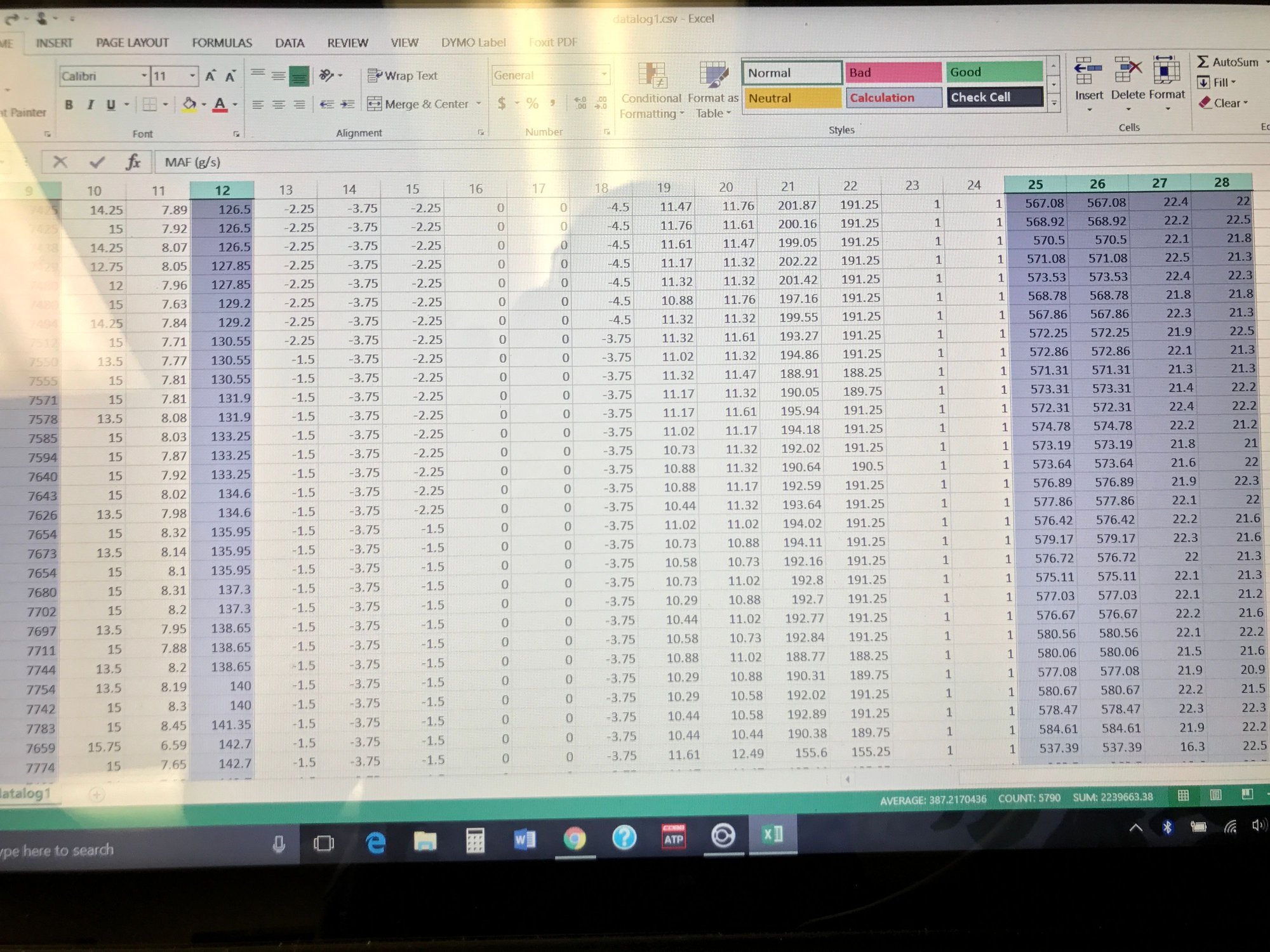

Cheers guys! Look at this air flow on the right at 7800 rpm! That's only 22psi!

Looking solid guys & this is on pump....just to think E85 is night and day!!
I am surprised that not only are these turbos making power past 7k+, it seems to be continuing to build power up past 7600rpm's with VTG's! Very impressive overall package to make this all happen and the fun is just getting started!

Bobby I know your on the fence bro. 2 fences actually haha. Cheers E85 will be interesting! So far I'm glad we have delivered and the best part is Daniel can drive the car hard no worries. It's a completely different beast for sure and it just pulls to 7800 so far just on pump we gained about 100!

How far do the stock MAFs read? What's the flow rating?
