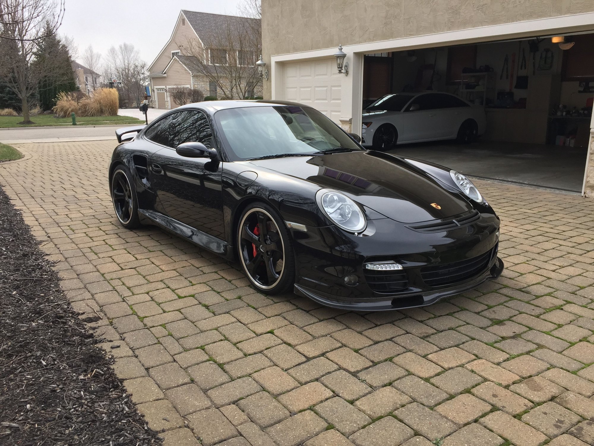

Good morning everyone,
I thought I'd start a fresh thread documenting the current build. For those that remember my previous thread, mine was the one that after installing a few mods had the dreaded camshaft error (spun sleeve). I was faced with a decision to just fix/pin the cams or go for a complete engine build making the car stronger and faster.
Well, my decision was to make it stronger and faster. Huge thanks to Sam at By Design who's been instrumental in pulling all of this together! Can't say enough about his support & advice, quick response and ability to move this along at a pretty fast pace.
Our overall goal for the build was to get around 900hp & 900 torque, maintain daily drivability, have power come in early & broad across the RPM range and keep power within tolerance not to damage transmission and suspension components.
First about the car, it's a 2007 Porsche 997.1, manual with about 25k miles. Great condition and has from the factory the full Techart package. Including pictures above. We decided to have Jon Bray rebuild the motor and go ahead an build it into a forged 3.8L. I'm attaching below a list of the engine modification along with upgraded/added bolt ons.
Should be one of a kind vehicle and something I'll keep for a long time! Engine rebuild is complete, it's back at Sam's shop and I'll be posting updates and pictures along the way including dyno charts once available.
Engine
By Design/EVOSpec 1200hp Capable 3.8 Stage 2+ build
- Full R&R and replacement of all wear items
- Cam Pinning
- Forged 3.8 With ring pak, Spec skirt and Coatings large pin
- Darton sleeves
- Case machine and final Cyl hone
- CP Forged Pistons
- Spec Carillo H Beam Rods
- Stage 2+ CNC Heads
- Inconel valves and Spec seats
- Ti valve springs and hardware for 8000 rpm
- Spec Intake and Exhaust cams
- Spec Crank finish/balance
- Spec 12mm head stud kit
- Spec custom head gaskets
- Spec bearing upgrade
Bolt-Ons
By Design Stage 4+
- By Design/TiAL 68mm+ GT2 turbochargers
- By Design 4.5 inch intercoolers 2.5 in/out
- Silicone boost hose Kit
- Silicone Turbo inlet pipes
- Billet Forge DV's
- BMC Filter
- IPD 82mm Plenum and GT3 Throttle body
- IPD Y-Pipe
- Kline Equal Length Headers
- By Design/Kline 76/70mm Race/Street exhaust
- Denso Plugs Gap .025
- 2nd Gen factory coils
- ID1300 Fuel Injectors
- Cobb AP
- Custom Dyno tuning
- SRE Sport Clutch
- New Dual Mass Flywheel
- DSC suspension module
- TS rear toe links
