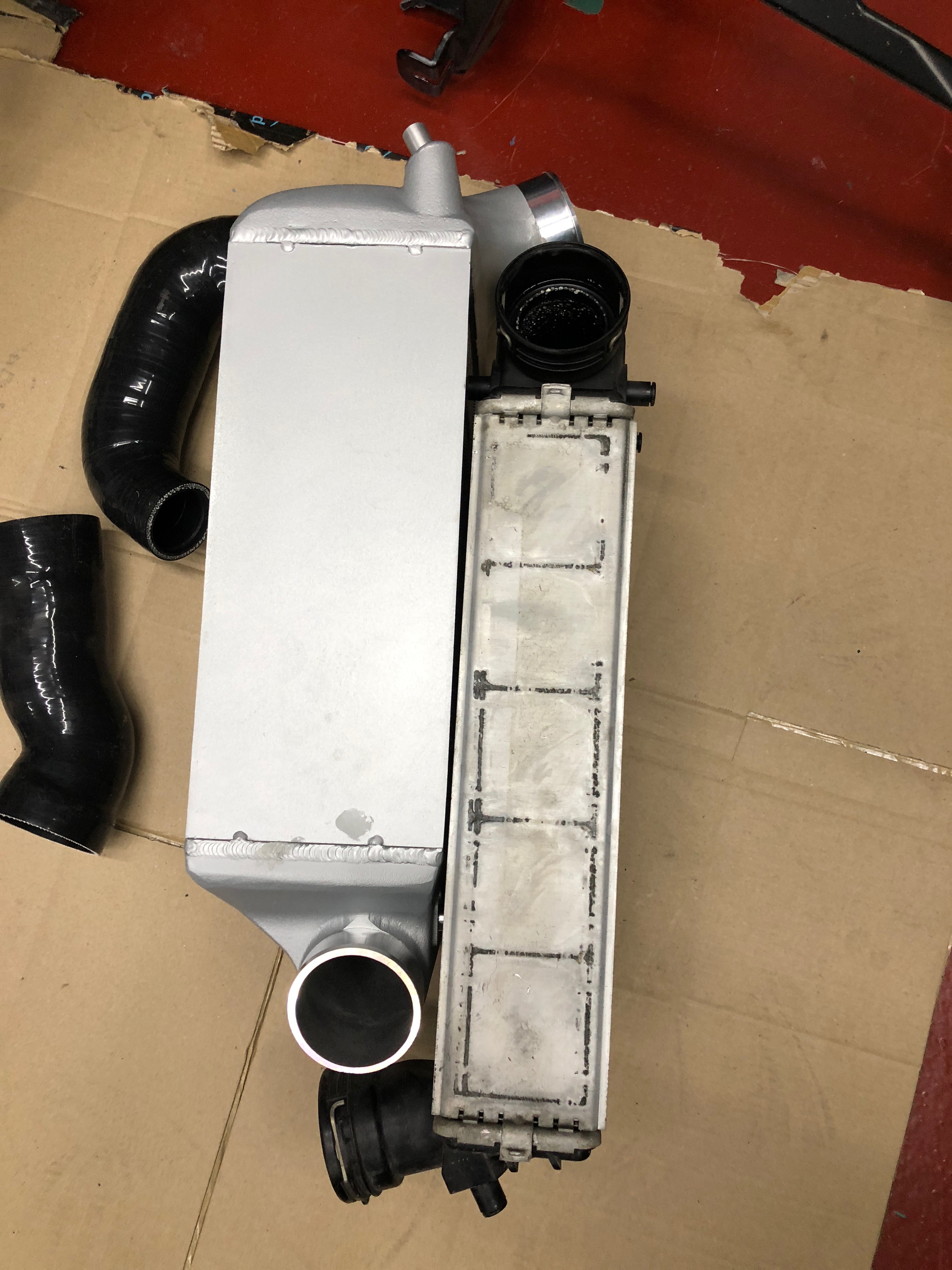

Yes, the $1000 kit has much smaller cores and uses the stock shrouds. They are an upgrade over 996 or 997.1 OEM ICs, but may or may not be any better than the 997.2 OEM ICs.

Per do88's website
Originally Posted by do88
...the weight increase compared to the OEM ones was relatively small considering the size of our intercooler and that its all made of aluminium. Our intercooler weight is 5,85 kg (12,89 lb) per piece and the 997.2 OEM intercooler weights 3,30 kg (7,27 lb) per piece. It might sound like a big weight increase but compared to other actors on the market with intercoolers in this size it's a low weight!

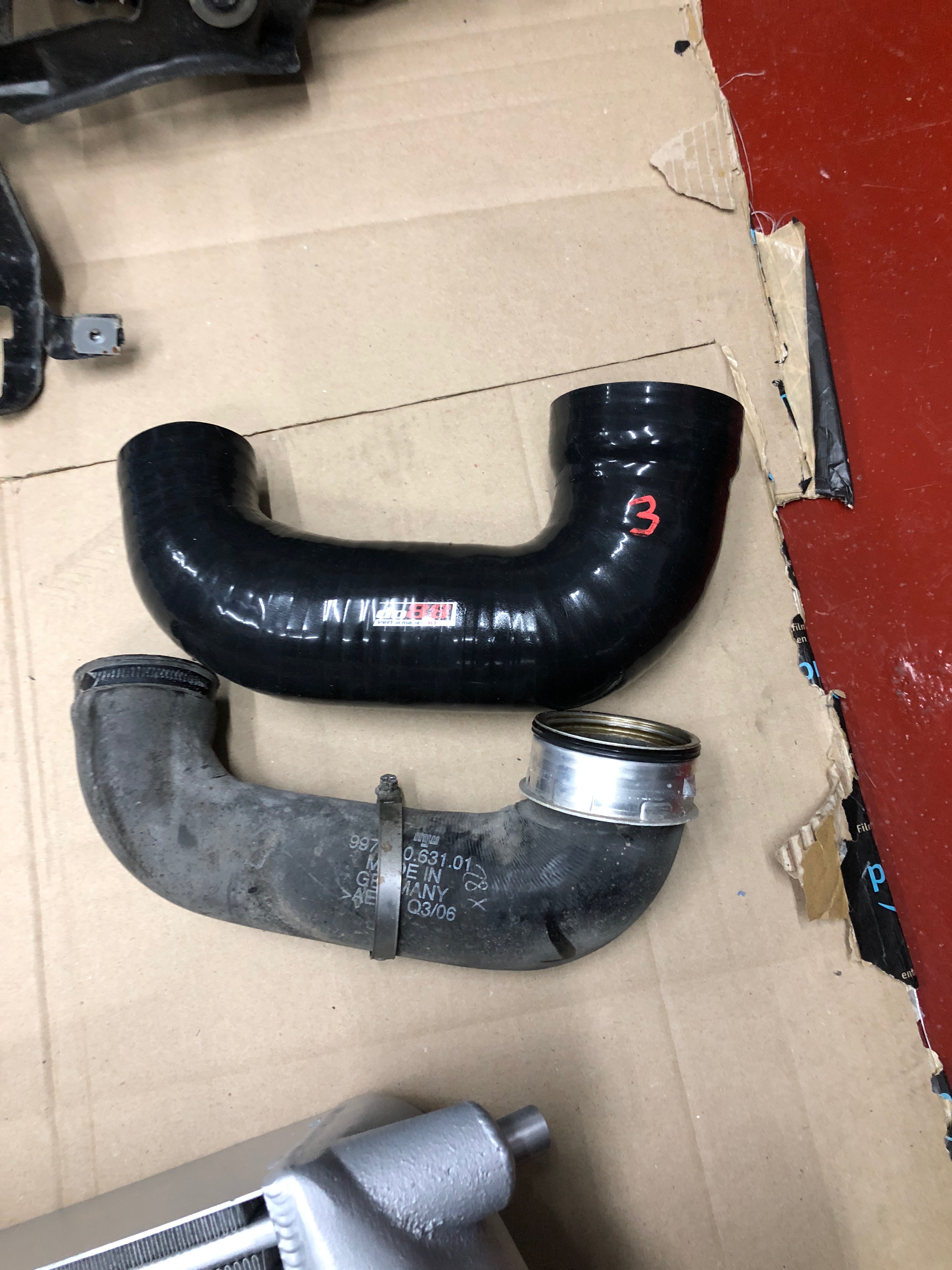

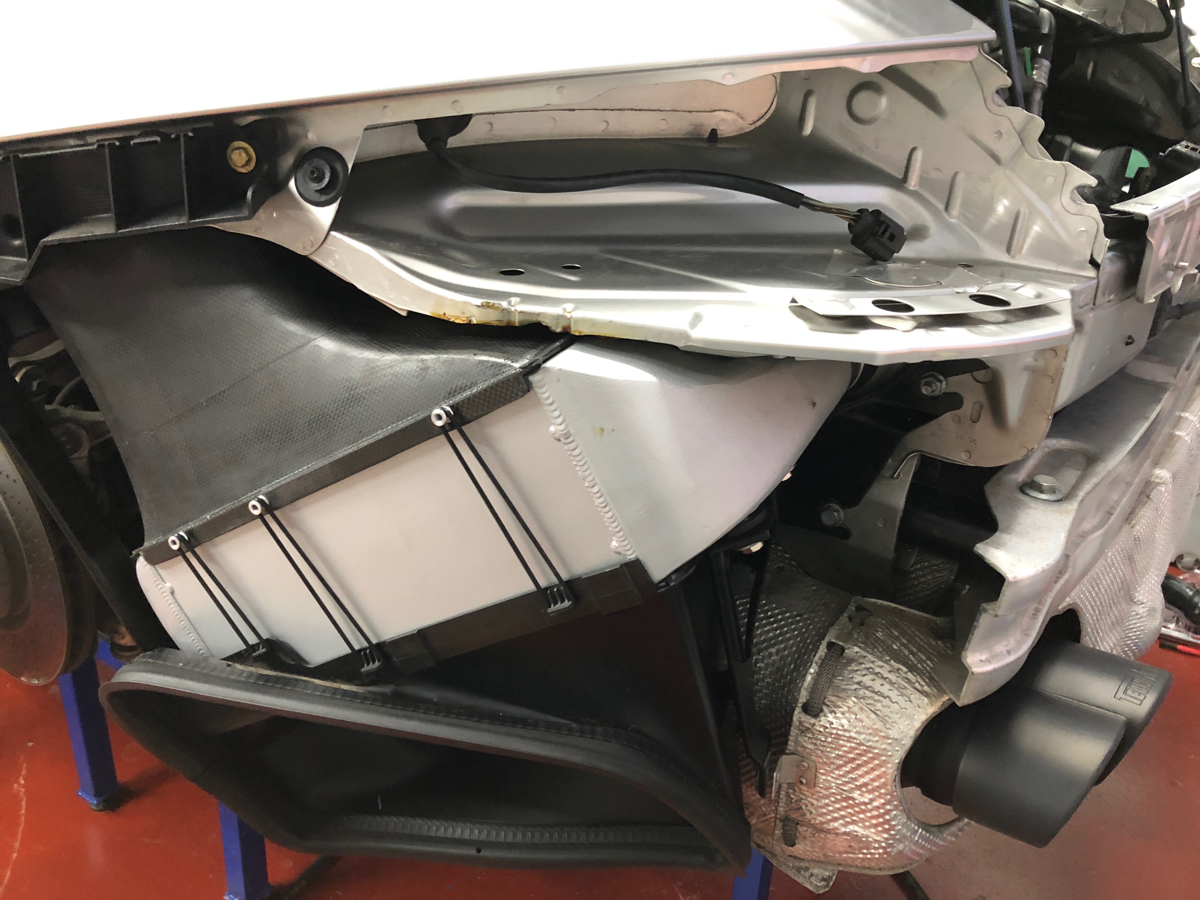

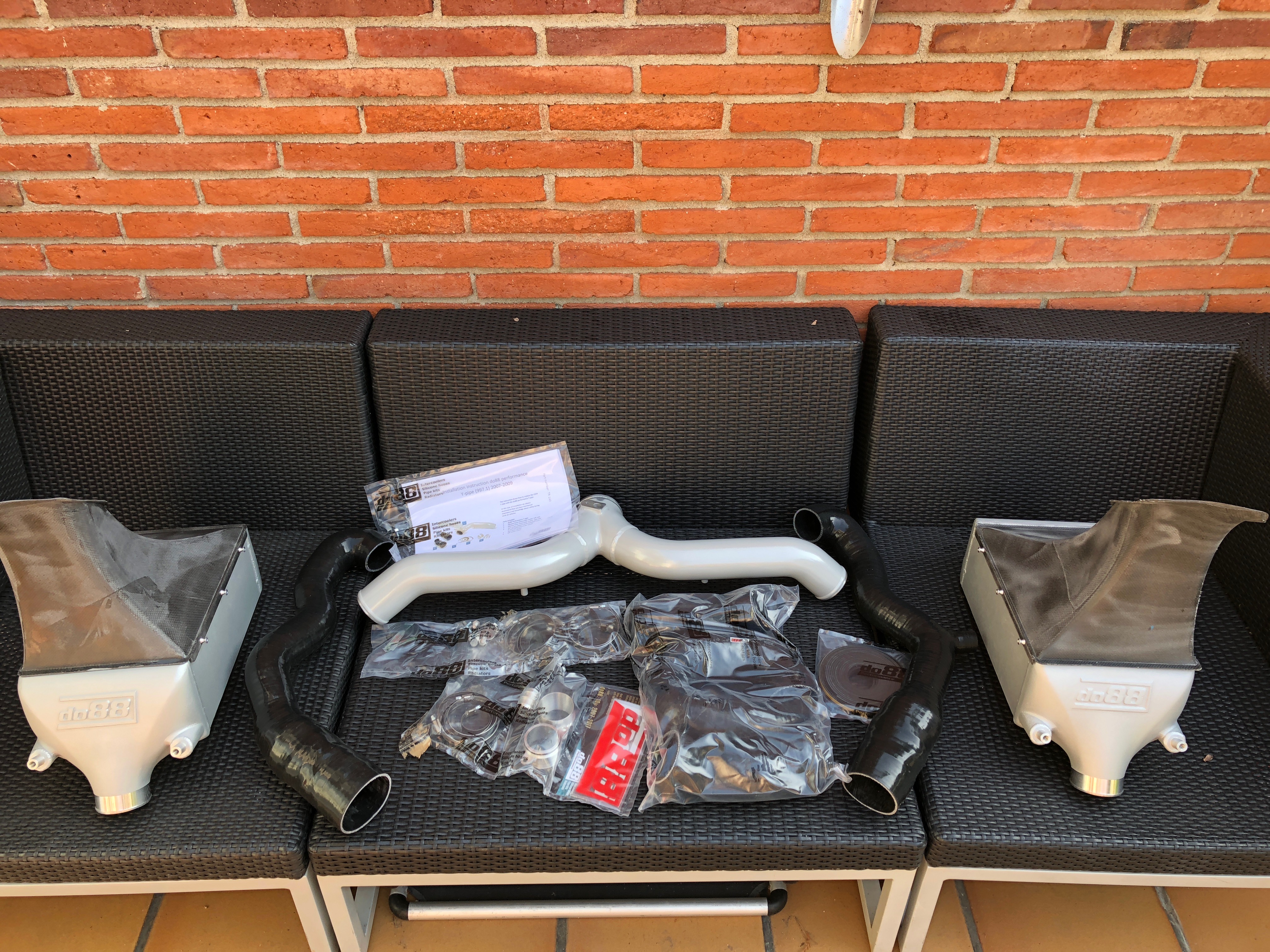

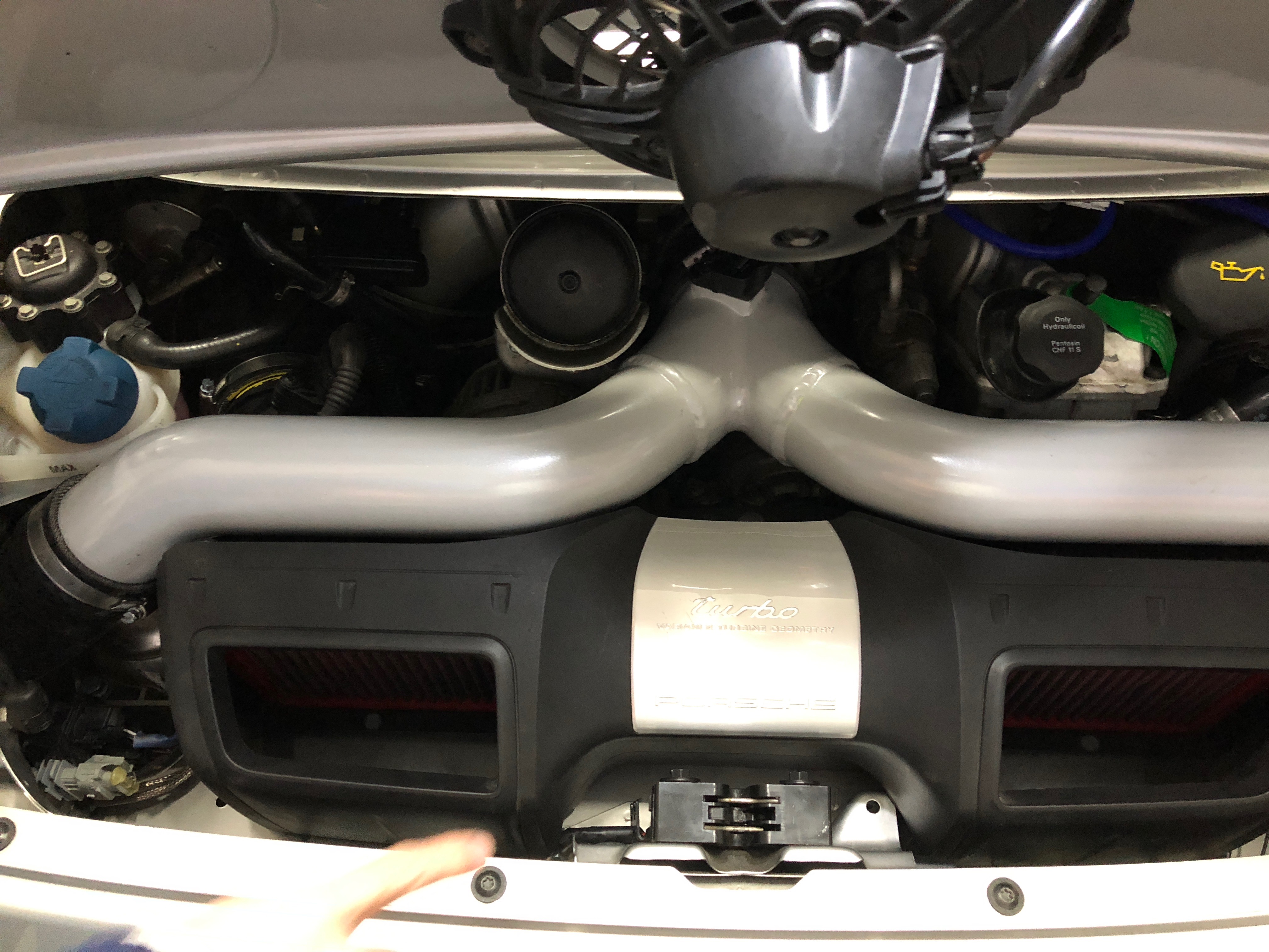

Old Nov 29, 2017 | 03:18 PM
  #27
JJT's Avatar
JJT
Joined: Feb 2010
Posts: 27
From: SPAIN
JJT is infamous around these parts
The difference is important

Wow, what a difference!

Anyone put bovs on this ypipe? Where do you put them so that they don't interfere with hood closure?
Old Nov 30, 2017 | 08:41 AM
  #30
Joined: Dec 2009
Posts: 6,584
From: S.Plainfield, NJ
Rep Power: 856
put them on the upper intercooler tanks. will give it a much cleaner look.
