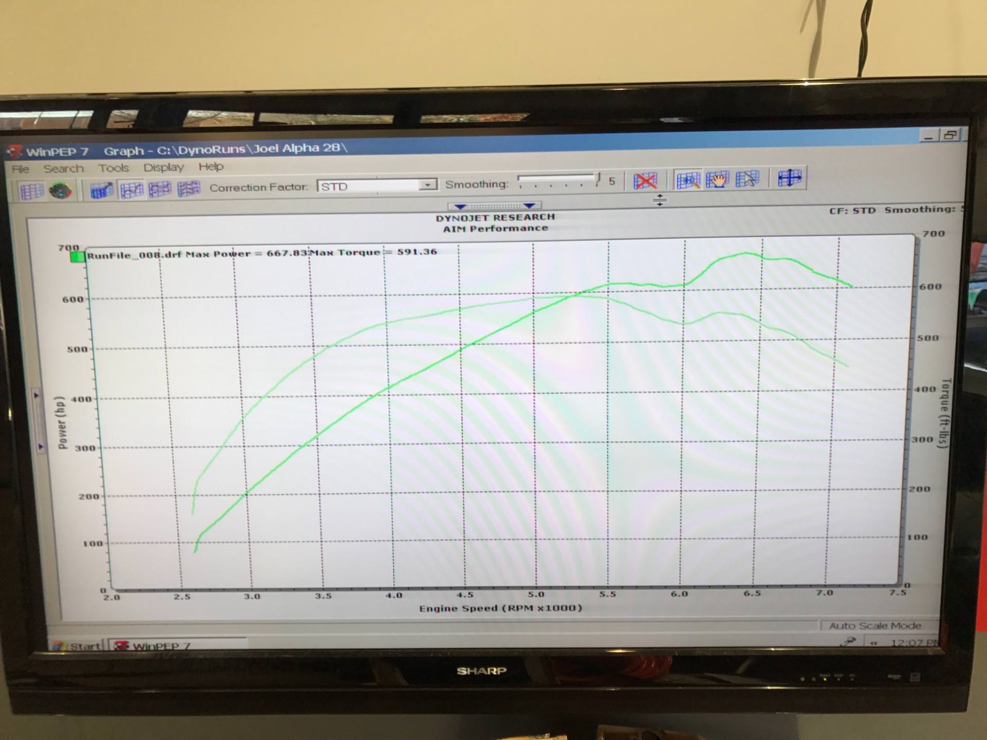

So after much back and fourth with Joe at AIM we finally settled on a bolt on build for my 997. I wanted to keep this car quiet and running pump gas only.
When i purchased the car it had a GIAC tune, AWE Intercoolers and Exhaust (with Cats), Bilstein Damptronics.
Last year i had AIM install a Sachs 2.5 and BBI Slave
Now added is
1000cc injectors
Silicone Intake Tubes
BMS Filter
AMS Y Pipe
Cobb Accessport (I hated the Giac Tune)
Alpha 28's.
I also had the cam's pinned and all coolant pipes replaced and upgraded.
The car made just about 670whp on a conservative pump tune. It's now....a party.

Another big thanks to Joe and AIM. Joe was patient with me and answered all of my questions quickly during the process. I am a very happy customer with a beast of a street car.

Originally Posted by thegame
It's gorgeous and a monster I am sure! Just curious why did you hate the Giac tune?
The tune was ok I guess.... But after thr vtgs hit there was a drop off in power and then a build up again
But my biggest gripe.... Was during shifts. There was no shift in the world that was fast enough to avoid the car falling flat on its face between shifts. That was why I really disliked it.
This particular issue is one of the most annoying, it even does it on stock VTGs. If you log it you will see it holds boost fine but it pulls quite a bit of timing between the shift and brings it back in causing the hesitation feeling. Not sure if some tuners have figured out what table to adjust but it really sucks.
Looking at WGT cars with a Cobb AP I do not see the same behavior in the few logs I have access to. So I am assuming setting the VTG table to 100% turns off that issue.
