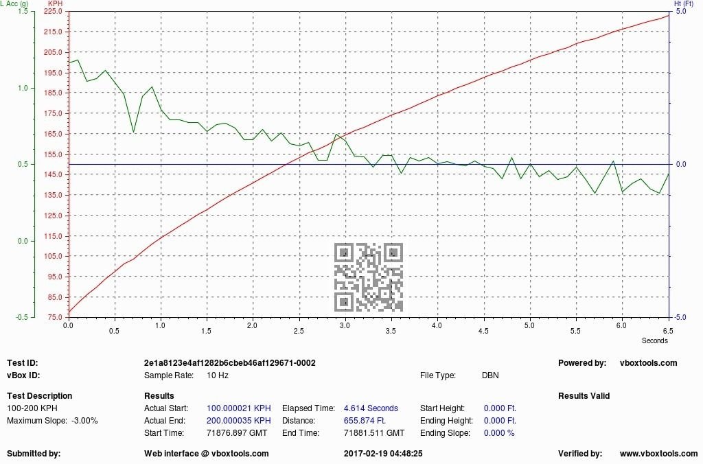

Before the port and fine tune
the car ran the below numbers
