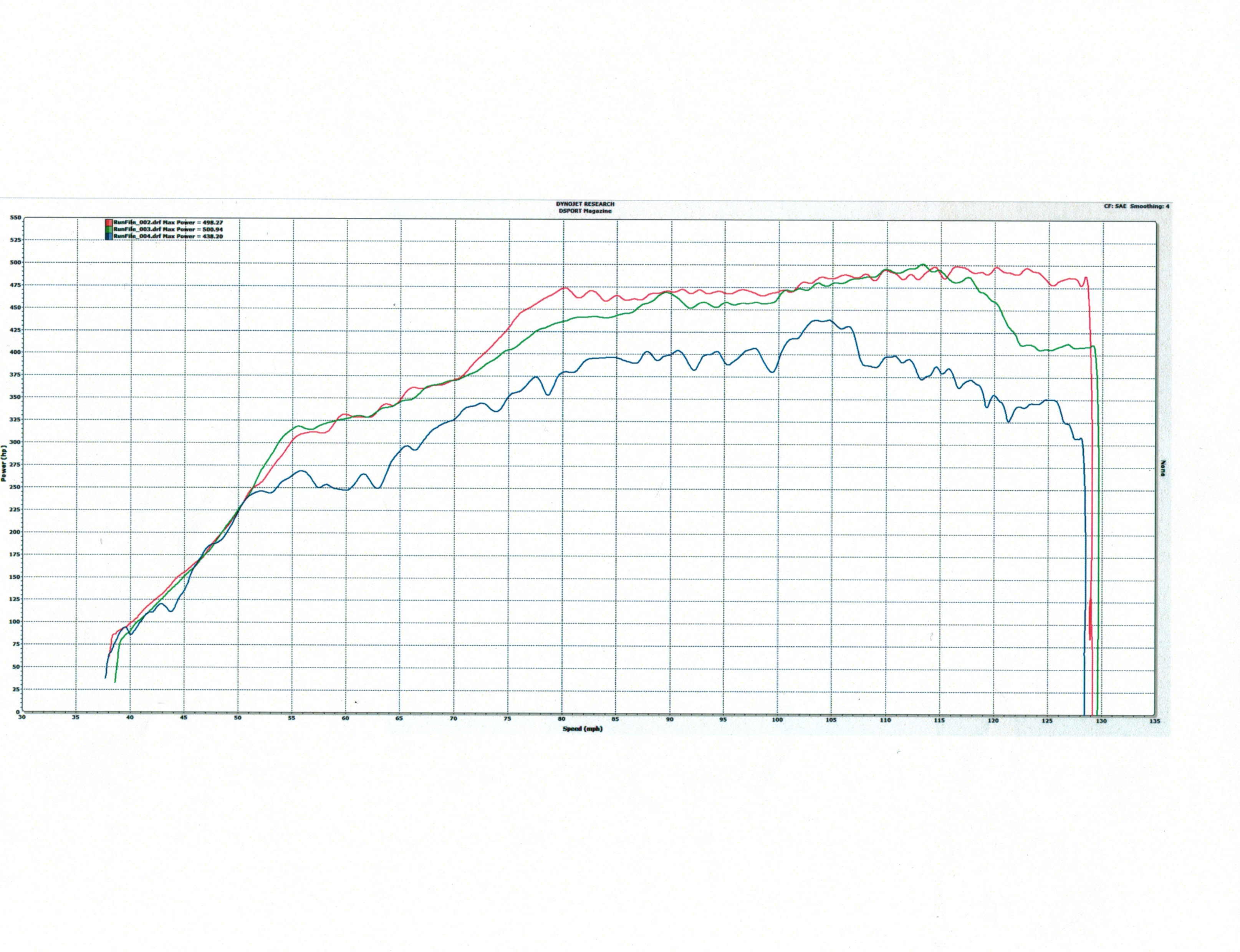

To extract the most power out of the IPD Plenum & Y-Pipe power package, we installed our custom protune. As shown here on the dyno graph, our custom protune delivered significant gains over both the stock and off the shelf tunes.

500 WHP seems very low for a tuned / bolt on Turbo S. Seems it should be in the High 500's for those mods.
Or is your Dyno on the major conservative side ??
