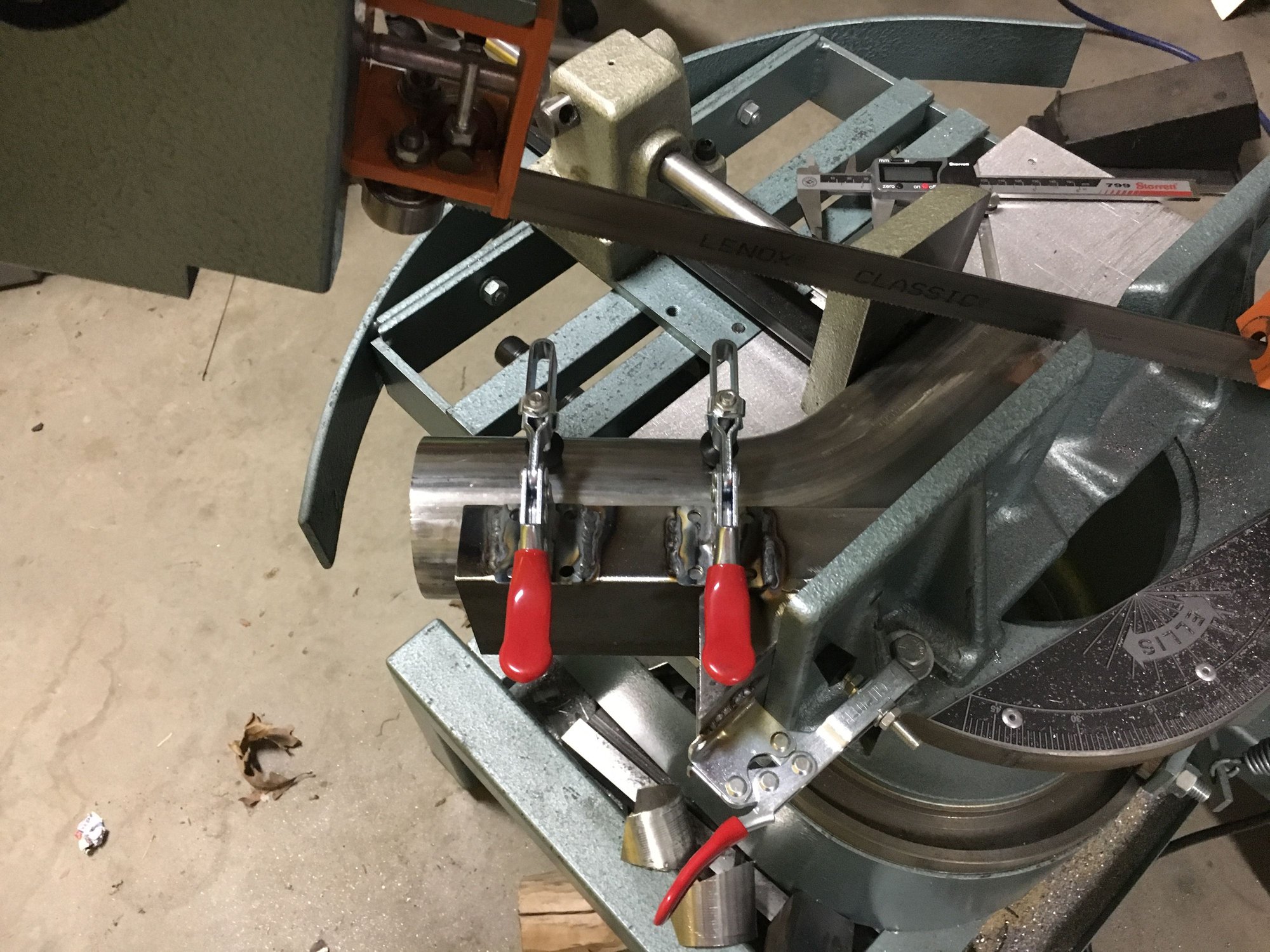

The machine's capabilities far exceed my own, and I doubt I'll ever outgrow it, which was a deciding factor when choosing it.
I bought the tubing bing from a local shop that bends tubing and builds exhausts for commercial trucks.
I made a saw jig to position the crossover tubes for cutting. I need all four to be exactly the same, so I bought some cheap Descato-style clamps and welded them to a piece of 3" C-channel. The clamps were covered in zinc, which is nasty stuff to weld. I stripped off as much as I could, but it was still present, resulting in gross welds.
