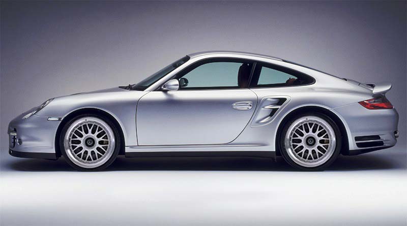

Wheels have got to go!!

hmm... something like this perhaps?

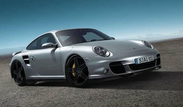

or... this?
