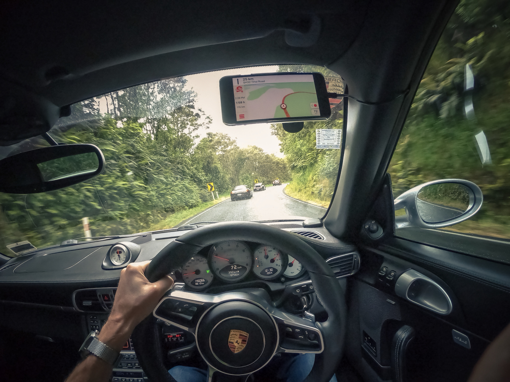

You'll need the 997.2 module to get the paddles working, the adapter from https://gpsadapter.us/ if you want multi function, and an airbag that fits the wheel. Once installed you'll need to get Porsche to code it for you. The link above has details.
The Panamera wheel will work, I've got a Macan wheel in mine, looks great.

Thanks NZSKATER for the info. Your steering wheel looks great. Looking forward to this upgrade
