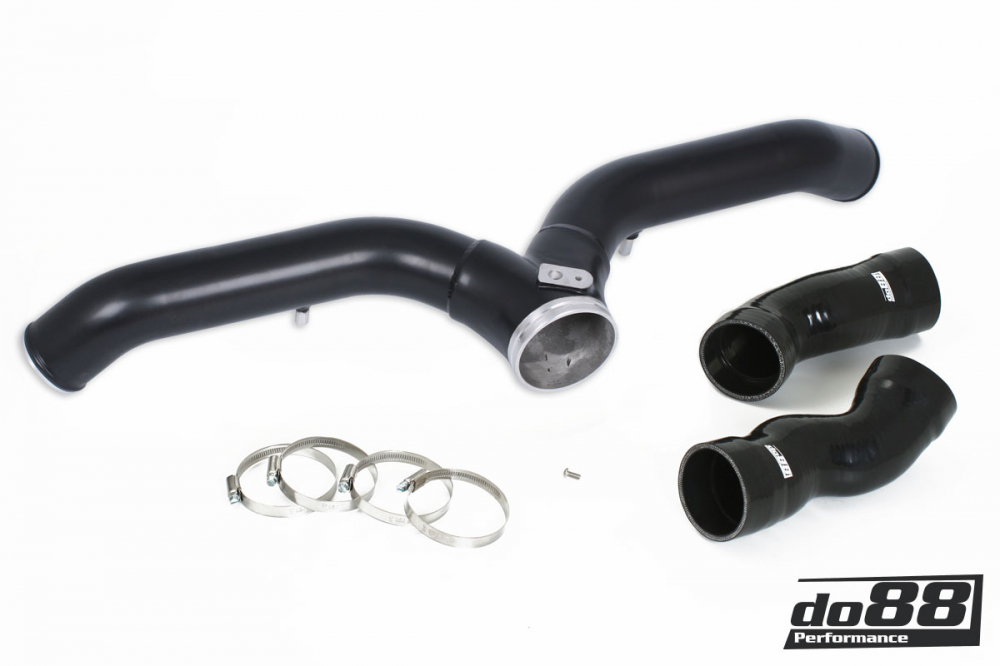

First of all i'm no engineer. I had a healty discussion with DO88 about their Y-Pipe some time ago. My car has the IPD oversize y-pipe (61mm diameter and 82mm outlet), GT3 82mm throttle body size and IPD competition intake plenum 82mm . Stock y-pipe is 54mm with 74mm outlet. DO88 y-pipe is 70mm with 74mm outlet.
They was trying to make me belief that their y-pipe was better than my IPD and to buy the complete big pack. This made me think that despite the y-pipe diameter from each 2 pipes, the flow will go out by just one exit to throttle body. So atleast, you would want that the area of each pipe to be half of the area of throttle body connection.
DO88 y-pipe is made for stock throttle body 74mm. If you want the 82mm throttle body they will supply a silicone reducer from 82mm-74mm to connect throttle body to their y-pipe.
So i went back to times of school, grab a paper and calculator and start calculating circle areas. Got this numbers:
Stock Y-Pipe IN vs OUT +6.10% in
(2x54mm pipes vs 74mm)
DO88 Y-Pipe IN vs OUT +44.12% in
(2×70mm pipes vs 74mm)
IPD Oversize Y-Pipe IN vs OUT +9.65% in
(2x61mm pipes vs 82mm)
And 82mm outlet has +18.56% more area than 74mm.
My conclusion was that DO88 y-pipe will always bottle neck at oulet 74mm, despite even going larger after to 82mm TB. So i bought their DO88 big pack with connections to stock y-pipe size and kept IPD system with true 82mm diameter between y-pipe and intake plenum.
Sorry if my feedback is wrong but that made me sense at that time.

Interesting, thanks for your input.... Are you positive you're comparing the DO88 unit here? I'm a bit skeptical about that info, as the outlet looks significantly bigger than that in their pictures.
Have a look here:
If the two merging pipes are 70mm, then there's no way that outlet flange is 74mm, unless there's some serious perspective distortion at play...
But even in the event that it is in fact 74mm, I understand your viewpoint, and if one were to go for a really high horsepower application, I suppose the 74mm outlet could be a limiting factor.
However, seeing as the majority of the gain in fitting a Y-pipe comes from a lower pressure drop and an improved merge collector, I reckon the real world net difference between the IPD and do88 items would probably be academic at best.
However, if I'm wrong, and my setup underperforms, then I'll know where to go looking for a power upgrade.
Edit to add: I mailed Isak at @do88 earlier to enquire, and I just saw his response:
So it would seem that the do88 outlet is in fact larger in diameter than the IPD... I'll measure it myself once it arrives next week (with a bit of luck) and advise.
Have a look here:
The inner bore facing the TB is 89 mm, and the connection diameter is 96 mm. We have never revised this item.
So my DO88 goodies arrived today, 5 days from shipping, delivered to my door (as opposed to having to fetch it from my local post office, like some imports), and also in spite of a minor clearing delay.
And it just so happens that I also got to meet up with my mate who muled the clutch, injectors and Cobb AP over from the US for me.
So with a bit of luck, we’ll be ready to install everything over the course of the next few days.
Oh, and I opened up the Y-pipe to check the outlet... it measured in at 88mm, so it’s unlikely to be a restriction point.
