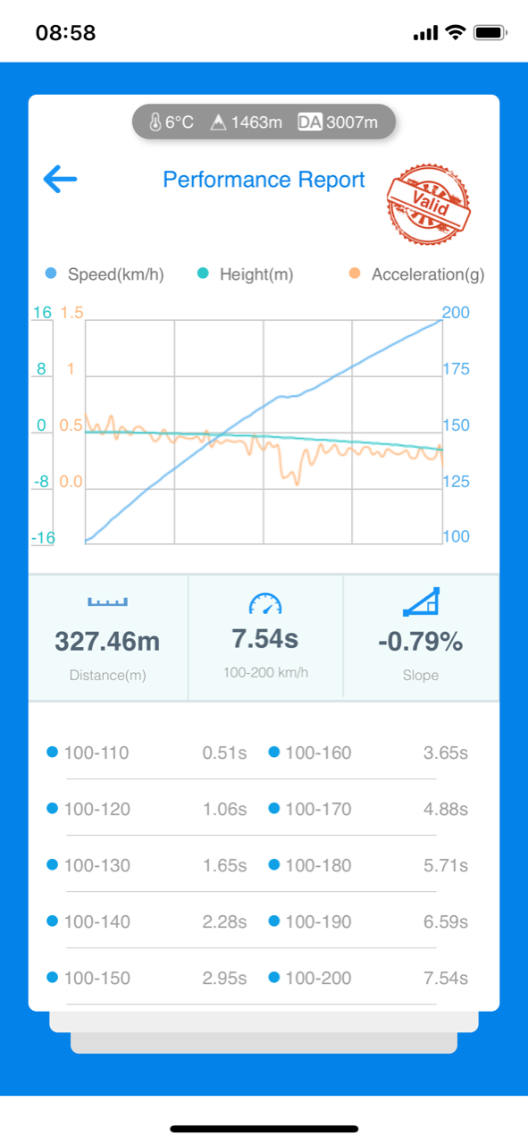

A bit of an update...
After a few map revisions, the the 997 Cabrio is pulling really nicely... Sam's a bit concerned about the high wastegate duty cycle, but given our crappy 8000+ DA's at 5000+ ft elevation, it's to be expected.
A pretty respectable 100-200 run, considering it wasn't even done in Sport mode, and done 2-up in a cabrio... should make for a mid 8-second 60-130.
Truth be told, I think the Dragy's DA is wrong - actual DA should have been in the region of 7000 ft based on the TRC app's data at the time.
Even so, having done a bit more poking and prodding, comparing local Dragy results, etc, it seems even fast turbo cars are quite a bit slower at these kind of DA's than they would otherwise be at more reasonable DA's. A calculator I found claims that a 7000 DA corrected to sea level, would have seen this same 100-200 run completed in the region of 6.9 seconds.
I need to log it again so Sam can do another map revision with tweaked boost and timing - but I haven't even driven the car in nearly a month now.
Turbo upgrade plans have been shelved for the time being, as we're in the process of buying a new place.
