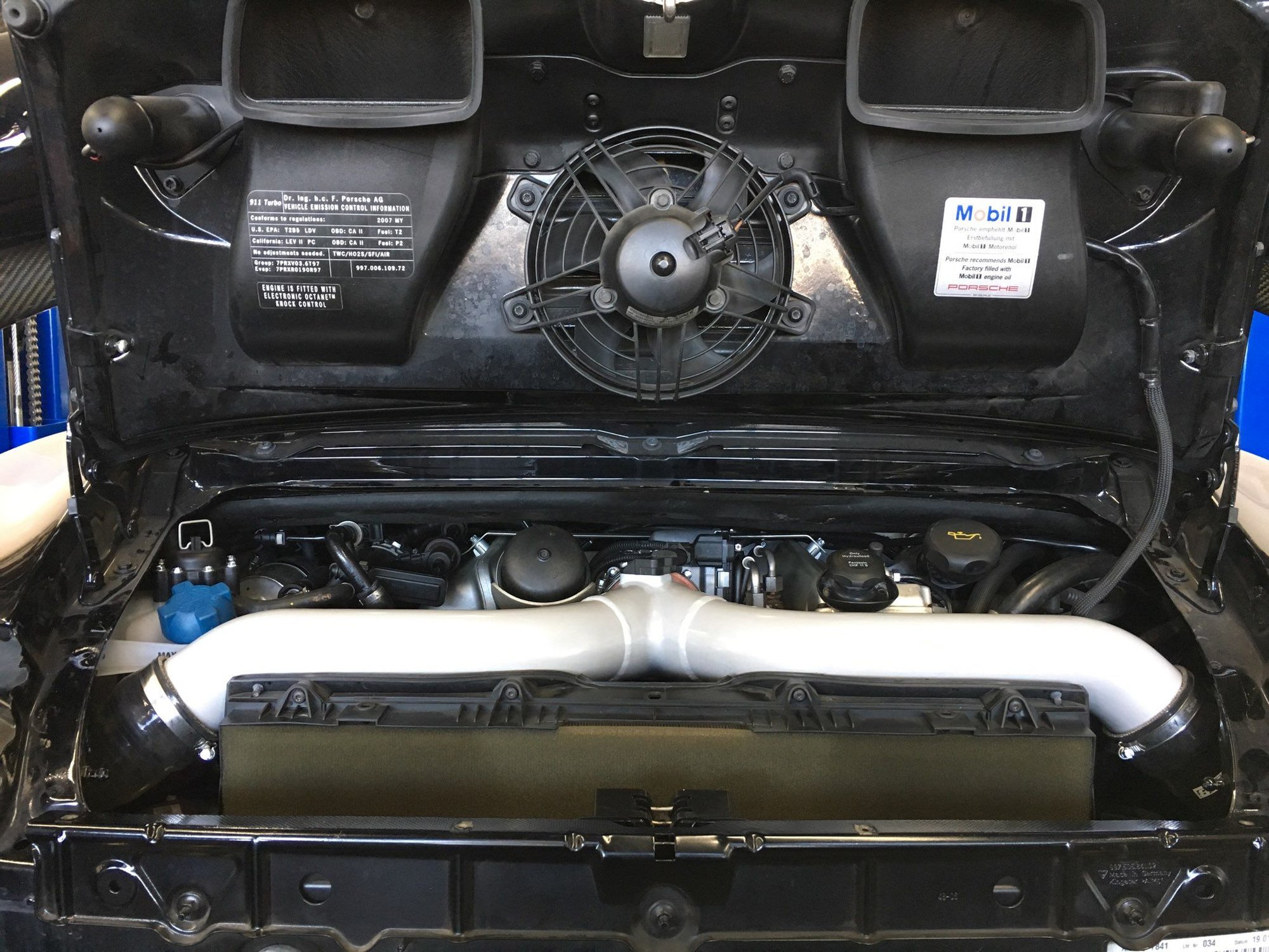

Originally Posted by AIM Performance
We're a big fan of the Big Pack. Fitment is great. No cutting or modifying. This is what's on our record holding 997.1TT
You must have gotten a "ringer" set of intercoolers and ypipe, lol.
My shop had to cut a little of the frame underneath, similar to what's in the pics above.
I got a call yesterday saying the trunk wouldn't close with the ypipe. Some fiddling necessary for sure. I think they were referring to the hydraulic lifters for the spoiler but that was what was bumping into the ypipe. I will see tomorrow what they mean but it doesn't sound like it was a no-brainer install...

If you notice above, I talked about the same issue. They don’t have the correct couplers on the correct sides of the car. See above.

correction: I think they were referring to the trunk lid hydraulics being in the way

I did notice you pointed that out...he told me he has the longer piece on the drivers side because if you put the longer piece on the passenger side the ypipe isn't level

mine looks like it sits higher than yours? they took the trunk hydraulics off. Obviously something is wrong somewhere if no one else had to do this....
