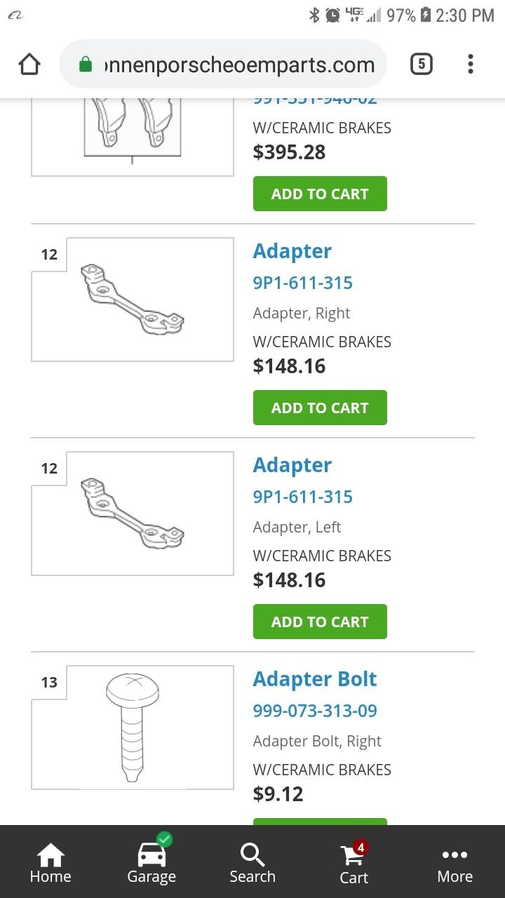

Adapters will only be needed for the front. Here are the part numbers. Need adapter and bolts. Need to make new brake hard line as well from the cost line adapter to the calipers. Can get hardline at a parts store and bend yourself easily.
