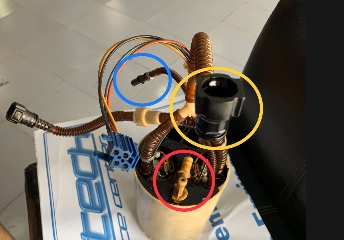

Found these two pictures, above is the stock basket before I tore it apart. The 3 circles are the feeds you need to account for:
Red and Blue feed the jets Red is 3/8 blue is 5/16
Yellow feeds the hat 3/8

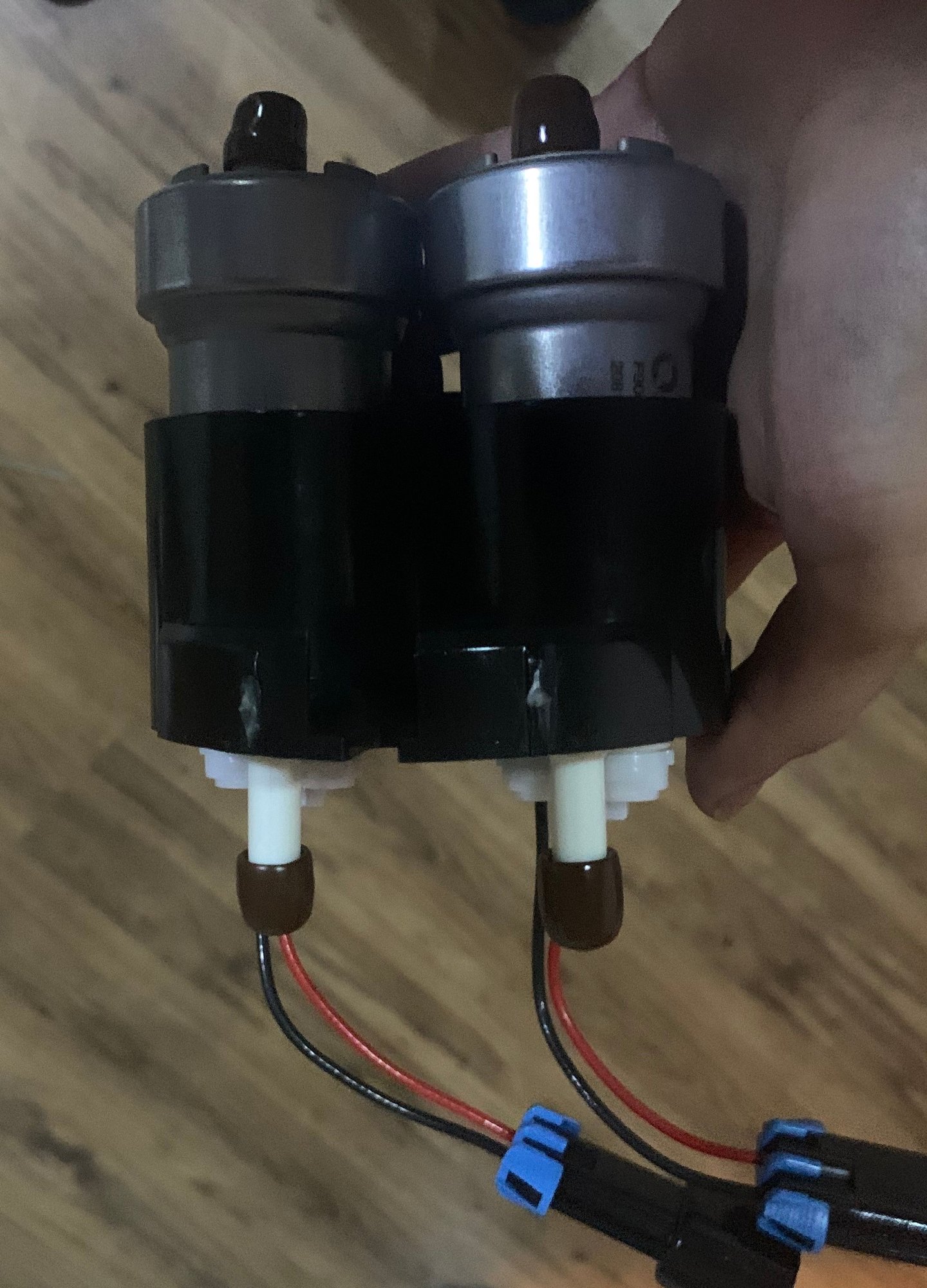

Bellow is how well the walbros fit in upper part of the basket ...
