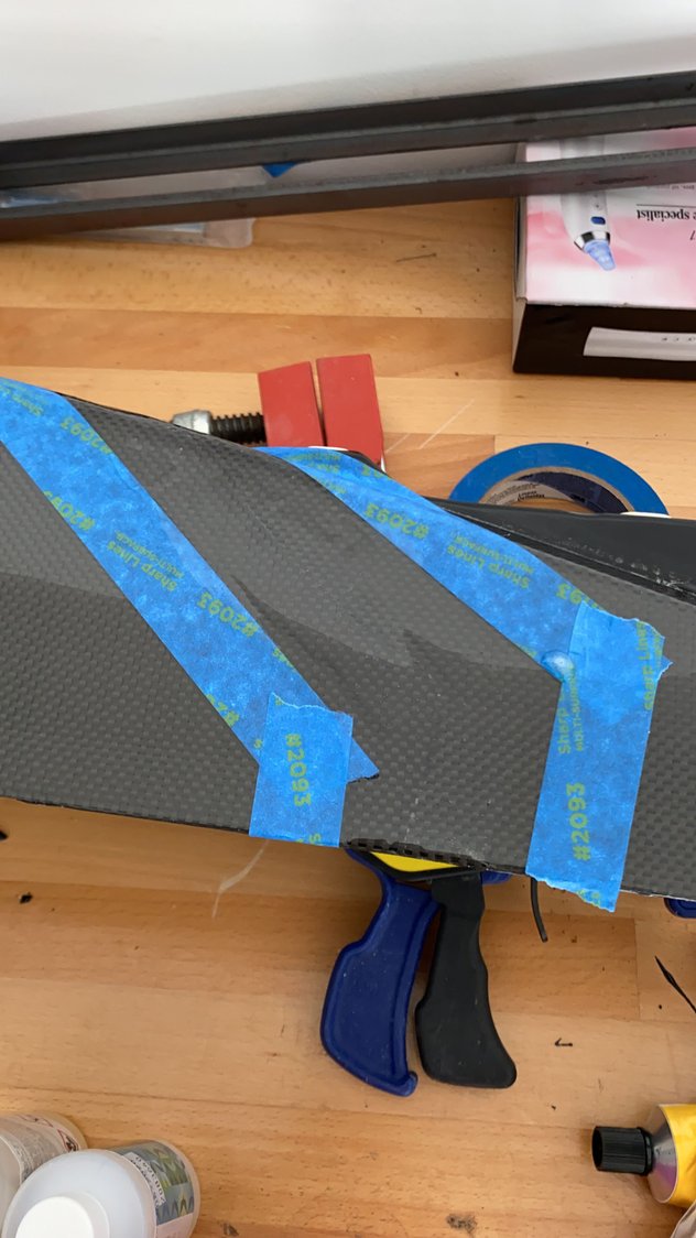

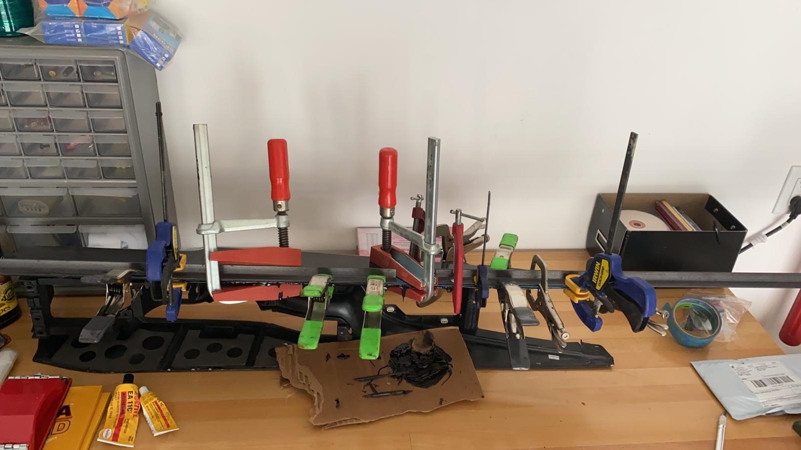

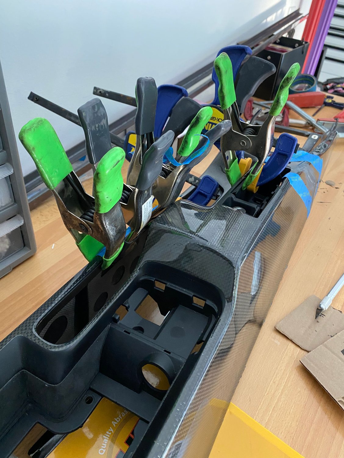

Epoxy the lifted areas carefully.
I used loctite EA11c in black. I wanted a flexible, strong, up resistant epoxy that is resistant to heat. I wanted to grind down first to relieve any stress in the resin. The thinner the factory resin, the better. I epoxied down any lifted areas first and used lots of clamps.

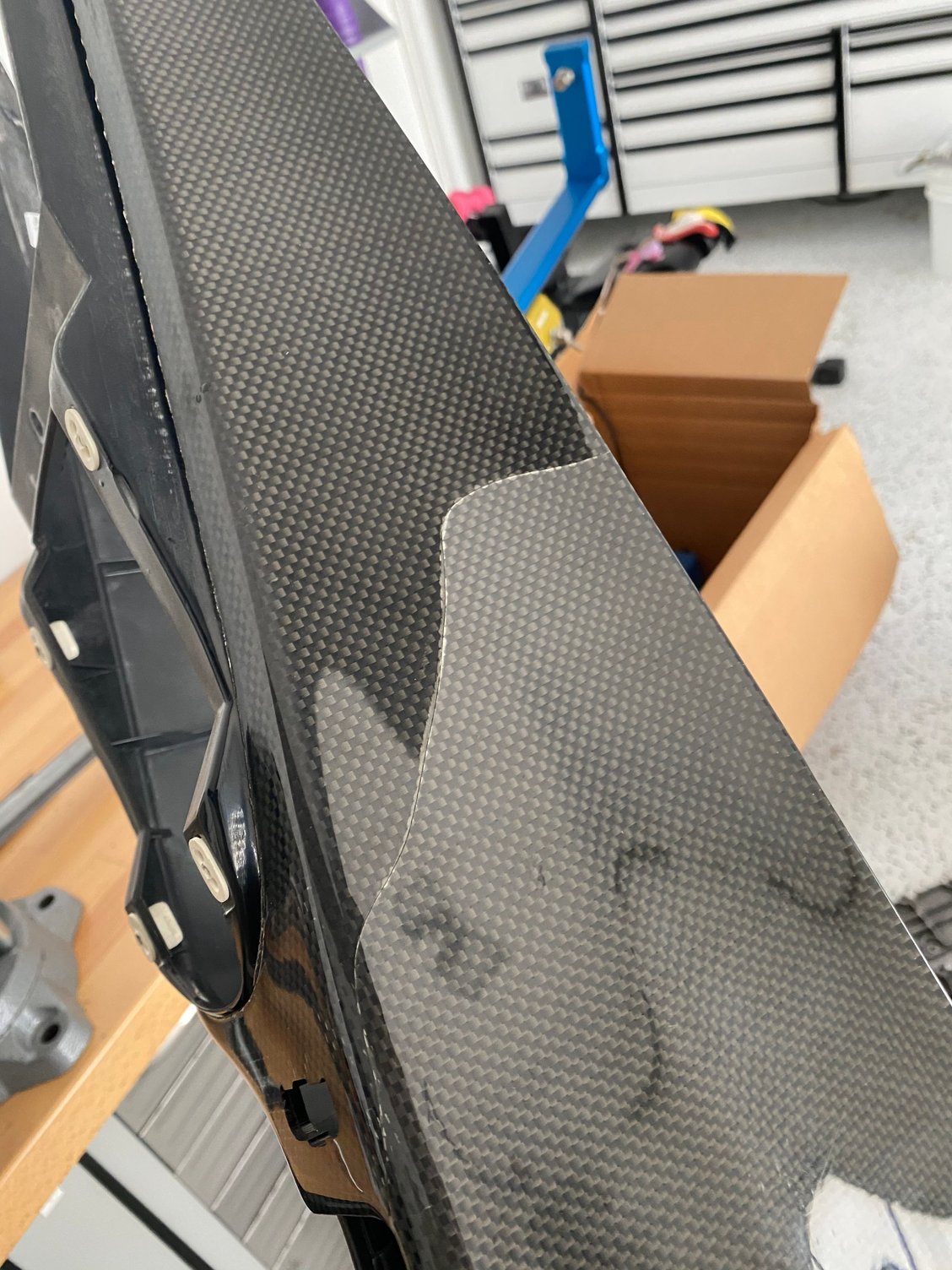

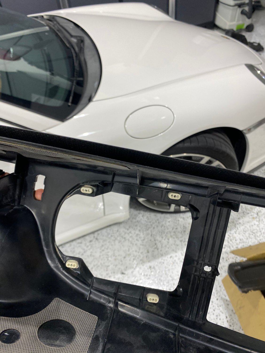

Typical lifting of carbon on 997

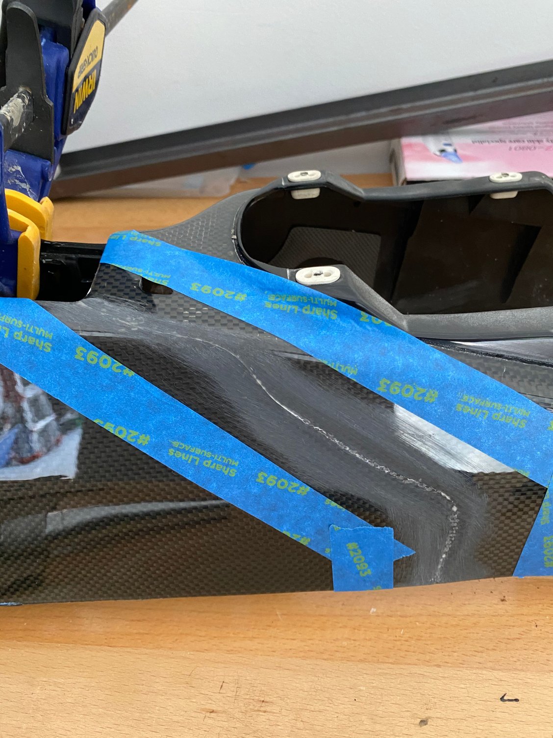

Resin
Once all the structural areas are repaired, time to sand a little. Feather the areas of the crack creating a valley for the resin. Clean the area with alcohol. Make sure you DO NOT TOUCH the carbon fabric. If you disturb the carbon, it will show in the final finish.

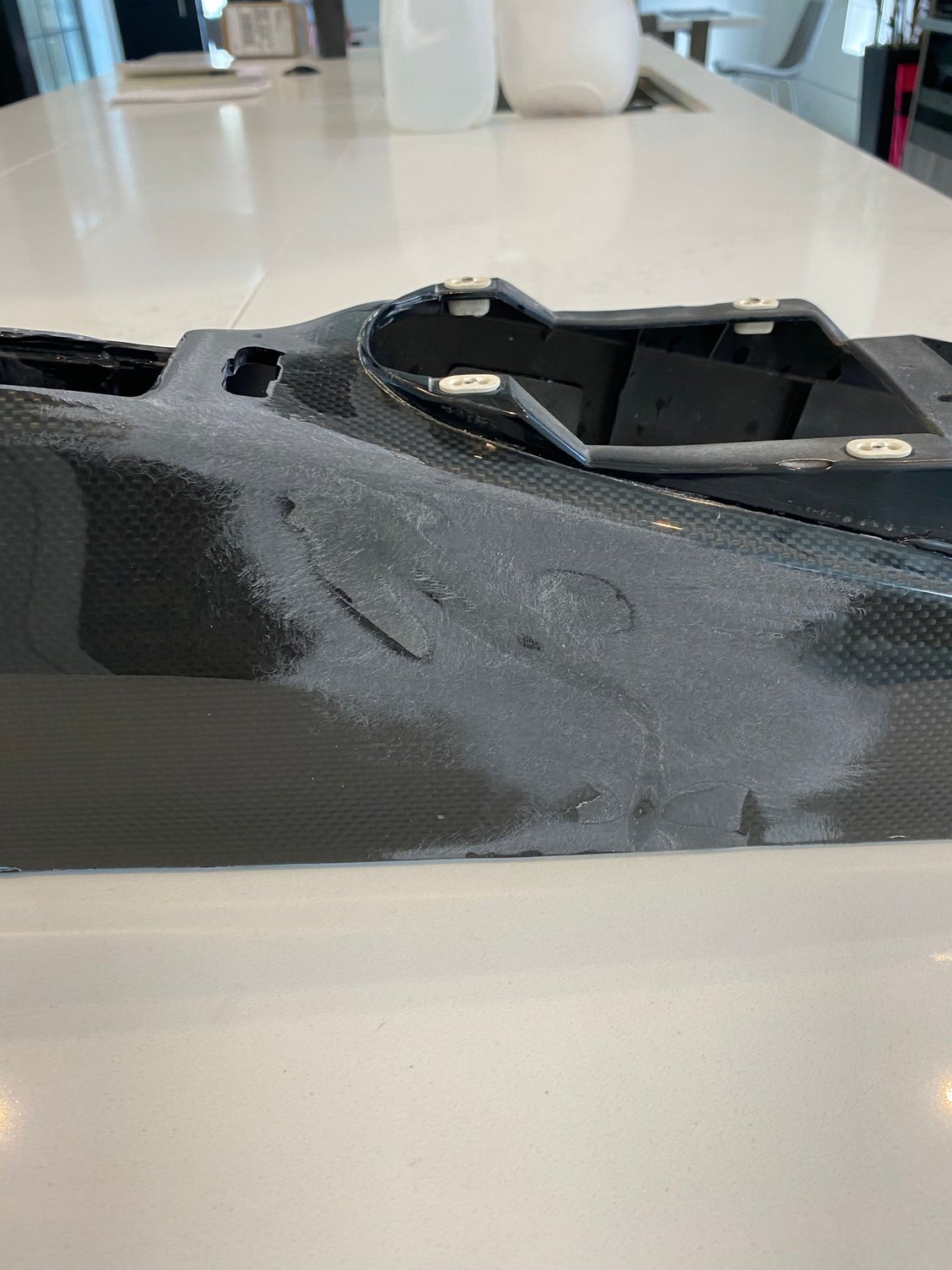

Below is after sanding down the high spots with 100 grit. I have a festool sanding system with vacuum which was a lifesaver. Made sanding the console quick and clean.
Old Aug 14, 2020 | 03:40 PM
macmann's Avatar
Joined: Jan 2015
Posts: 119
From: Houston, TX
Rep Power: 16
macmann is infamous around these parts

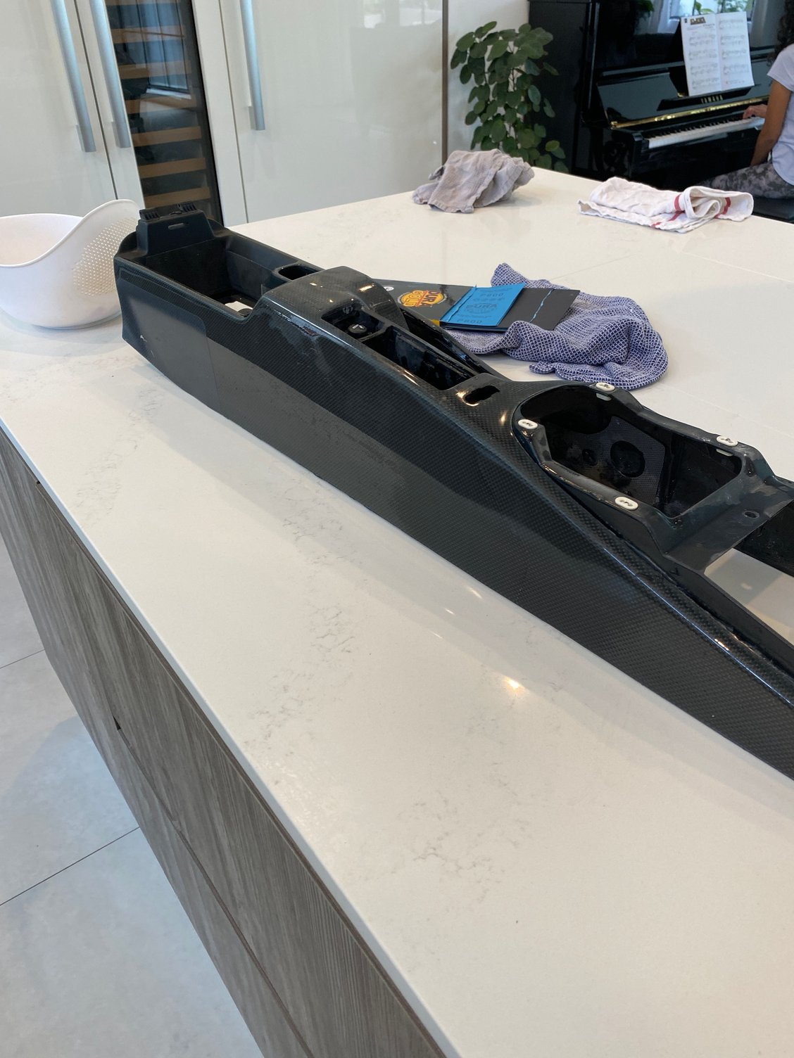

Below is after going through several stages of sandpaper. I dry sanded up to 1000 grit and started wet sanding with water from 1200 to 3000 grit. I still need to apply a coat of polish and remove any fine scratches. IF you look carefully, you can still barely see the kink in the carbon fabric but the crack is gone.
