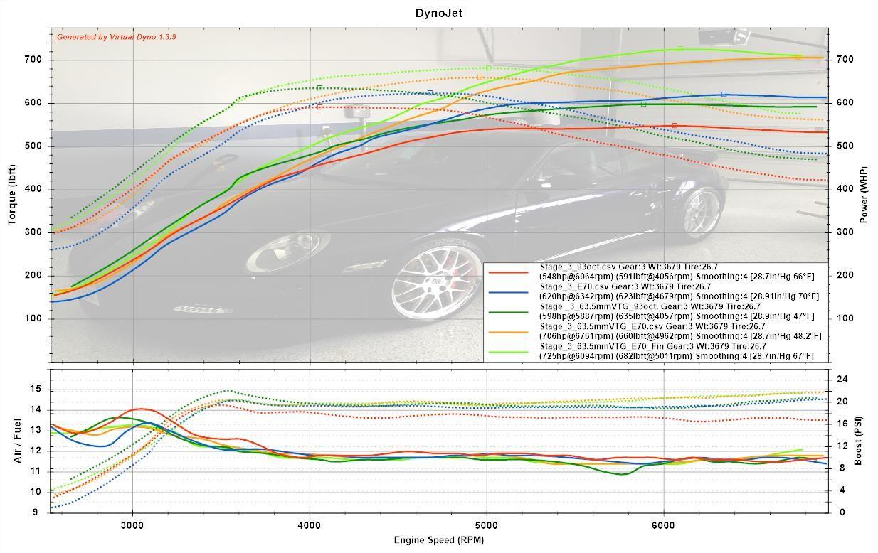

Wanted to give an update on the stock GT2 turbos. Running a Todd OTS tune with about 1.4 bar, 85% duty cycle on stock injectors, and full bolt-ons: Do88 big pack, inlets, 2,5" exhaust, calculated dyno based on fueling data from Durameteric:
flat power curve from 4500->up due to the compressor wheel limitation. Also, some knock showing up above 5,000 after one or two hard runs, so flashing a new tune targeting a max boost of 1.25 bar. Still want to keep stock turbos. What do y'all think?

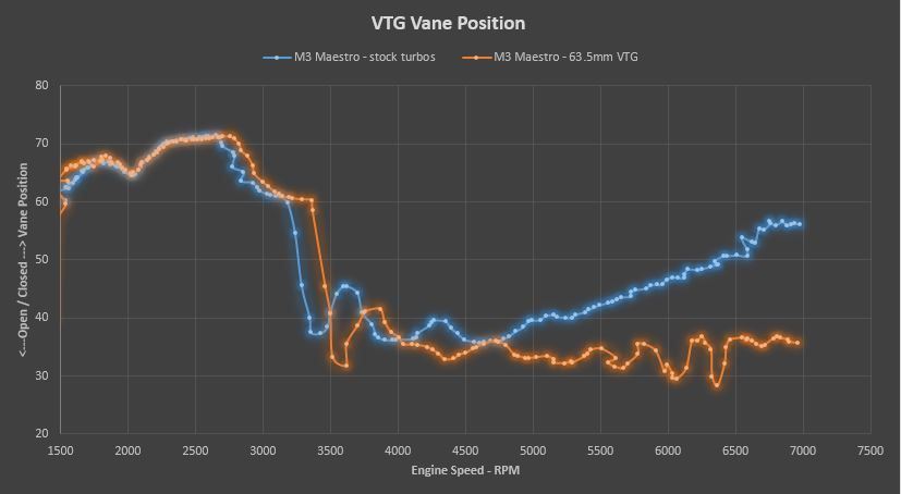

OK yes there are many plots showing what the 63.5mm would do, there is a ton of info I have dumped in my build thread but I'll put some on here. In regards to keeping your GT2 turbos stock, I wouldn't hesitate to use "standard" Turbo VTGs as your core to make the 63.5s. I realize and understand all the differences between the 2 however everyone is thinking about this in fixed geometry terms. You guys ever think about where all the possible throats are in the VTG? Turbine inlet throat area and wheel is not all of it. In other words I wouldn't lose sleep over it my friend. The 63.5 will have their turbine wheel clipped also when you upgrade, it doesn't need it anyways but they do it because of their experience on fixed geometry turbos which is fine. It will increase the natural frequency of the wheel and give you better HCF (high cycle fatigue) which will increase the shaft speed limit. But many don't realize that the turbine wheel will actually be spinner slower now when coupled with a larger compressor thus not needing the clip lol. This is why we speak in tip speed not in shaft speed when breaking down where the limits are in a particular turbo assembly. The turbo assembly, from an ultimate speed perspective, will have different limits for the compressor stage, turbine stage and bearing system, we pick the lowest one and call it the speed limit in shaft speed terms. This is extremely simplified and high level but wanted to give some perspective. Anyways probably more info than needed on a forum but any other turbo engineers lurking out there will appreciate this.
All that rambling to say, yes I think you have some gains if you go 63.5 VTGs . I recommend you check what vane positions you are running, reported as turbo duty cycle I believe. I run much more open vane positions compared to the stock turbos which means less pumping work (lower exhaust gas in cyl and less fuel for same power). In the dyno plots, my 93oct tune probably has more in it we didnt spend much time on it since I use e85 most of the time.
If you have any questions let me know.

Thanks M3 Maestro for your reply and data! My understanding of my stock GT2 turbos is that they are much closer to the 63.5mm VTGs than normal stock 997TT turbos are. They are already clipped per my understanding, but they just arent quite up to the level of the 63.5’s. If you look at my calculated dyno chart on post # 25 above, I look pretty close to your Stage_3 63.5mm_93_Oct (dark green) plot on your dyno. Both of us are just under 600 at the wheels at that point, but im flatter 4,500-up as mine starts to run out of compressor wheel. Normally, id be all about upgrading to the 63.5’s to correct that, but if I were to do the swap, the car would no longer be able to be put back to stock, which is an important consideration for a GT2. The market for these cars is largely collector driven vs people like us who want to actually drive and enjoy them.
To combat the possibility of knock for track driving on hot days, im reflashing for about 18 PSI down from about 20. Hopefully, that will not make a huge dent in peak power and will reward us with a more linear curve. Hope to have that data in the next few days.
It looks from your chart that stock boost is around 16? Is that correct? You have some great data there. Thanks for sharing!
