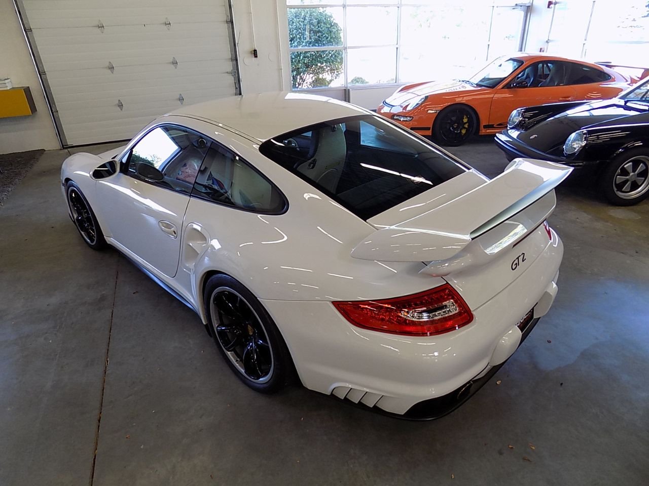

Thanks for the reply! Wish I could say those were all my cars…pic was at dealer when I bought her.

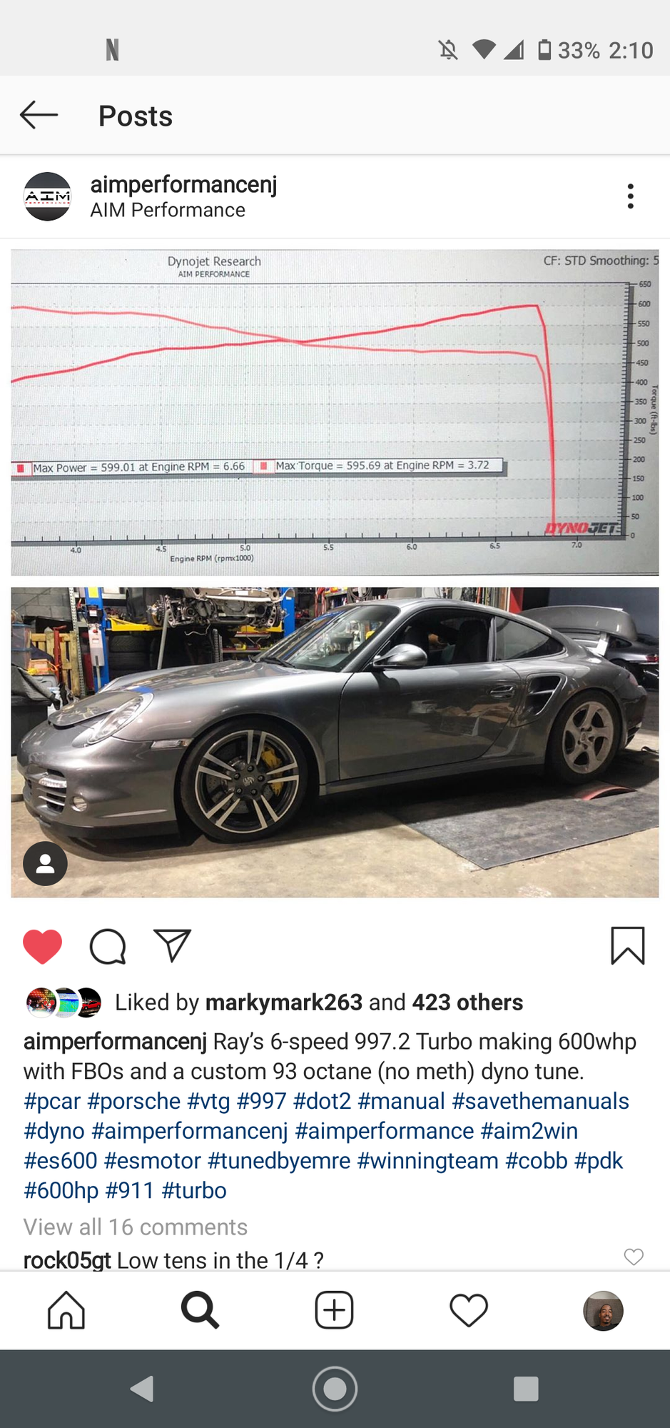

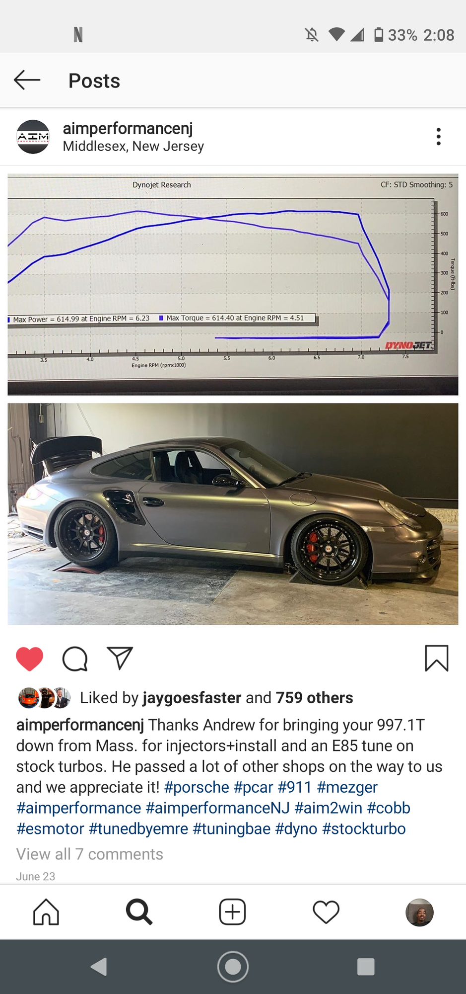

Here are two STOCK TURBO 997's both making 600whp. One on 93 and one on e85. I think you can reach your goal considering you have a gt2 which comes with bigger turbos than a turbo.

Those are two stock turbo 997"s both making 600whp. One on 93 and one on e85. I think you can reach your goal considering you have a gt2 which comes with bigger turbos than a turbo.

Hmmm..well I was aware that 600 WHP was easily achievable on E85 with Stock GT2 turbos and bolt-ons, but certainly not on 93. That is news to me.
Tom @ Champion said on another thread here that 65mm VTG's can give you just about 600 wheel HP on pump gas.
Are you saying that stock GT2 turbos are equivalent to 65mm VTG's? That does not sound right to me but I just dont know any better at this point in my research.
