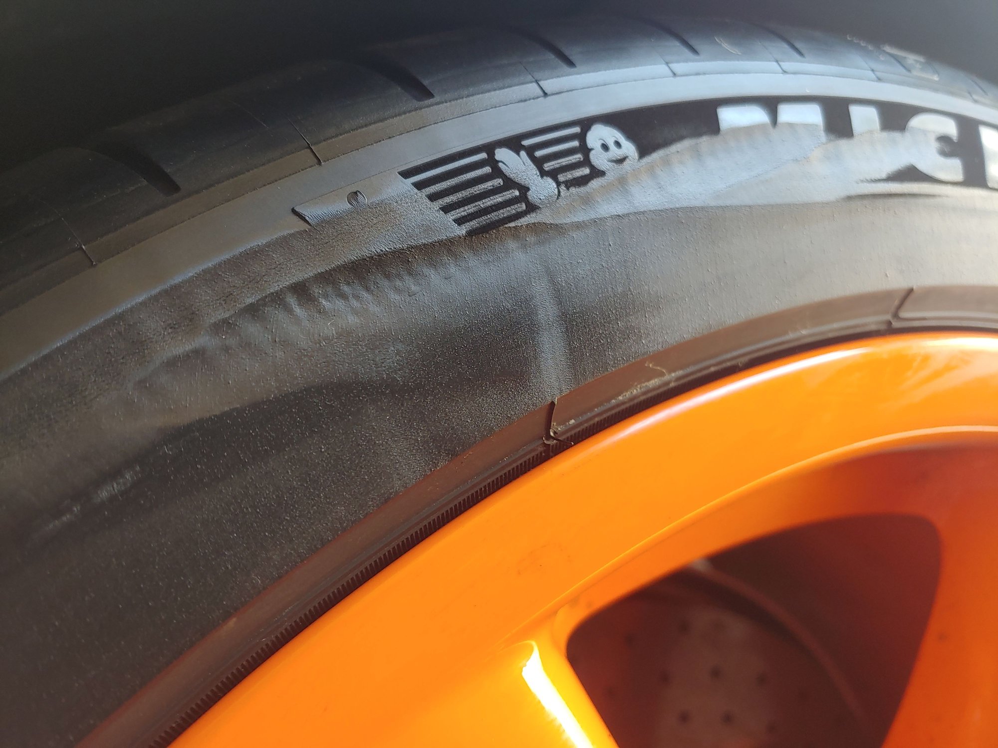

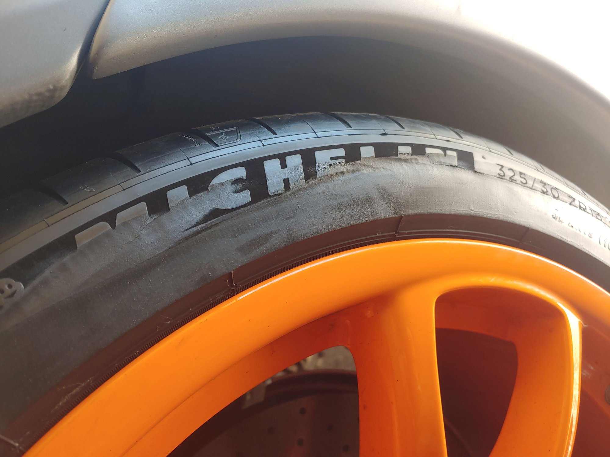

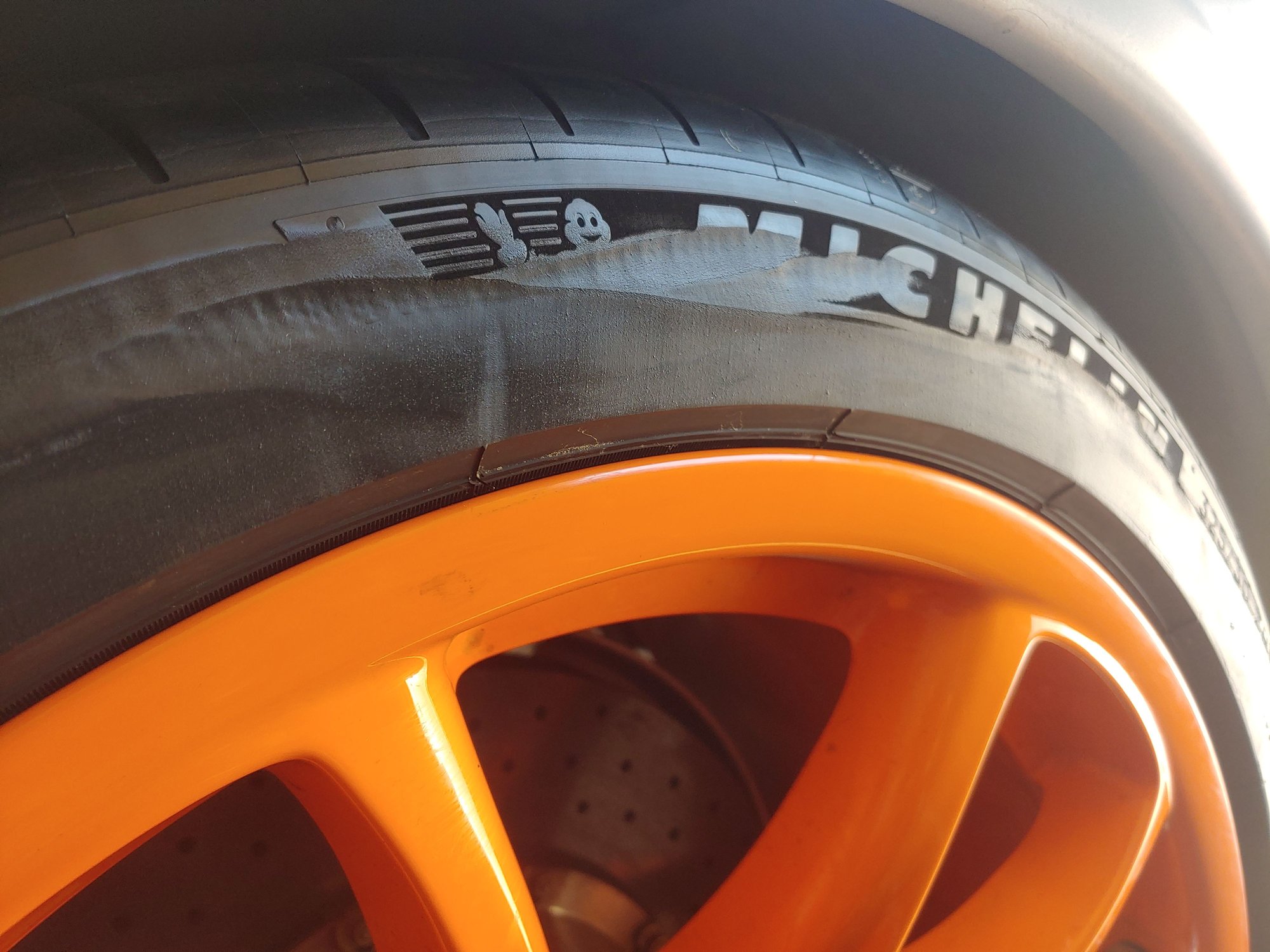

Please help. Got new tires. Noticed today
that one of my tires is rubbed off and you can't see the logo. I called the shop and the shop says that I rubbed it against something and i damaged it. I told them that I drove straight from the shop to home and haven't driven the car since then.
And if i damaged it, how come my rim is not damaged. I am very careful driving and never had any curb rash or rubbing on my car. Just replaced the tires and this one that is rubbed off was on a backorder from michellin for 10 days.
I talked to someone that knows about tires and says that this tire could have been damaged during shipment (fed ex conveyer belt). The shop doesn't want to take the blame and they say that i did this to the tire.
Thanks for any feedback.

How could you possibly do that much damage to the tire without damaging the rim? My guess is the tire was delivered to the shop in that condition or it happened during mounting the tire. I tend to doubt that it was delivered in that condition because a shop normally would notice it and wouldn’t mount it because they know the customer will notice it and blame them. If it was delivered in that condition they should never have mounted it. I would insist on replacement.

Before I saw the pics, I assumed you had rubbing from lowering... but then I saw it's the outside sidewall! It's almost like it was filleted. I could see a conveyor belt abrading that. I can't imagine how you would've done that without damaging the wheel too. The tire had to be like that before install or during. Either way, I wouldn't trust that sidewall anymore and insist the shop replace it.

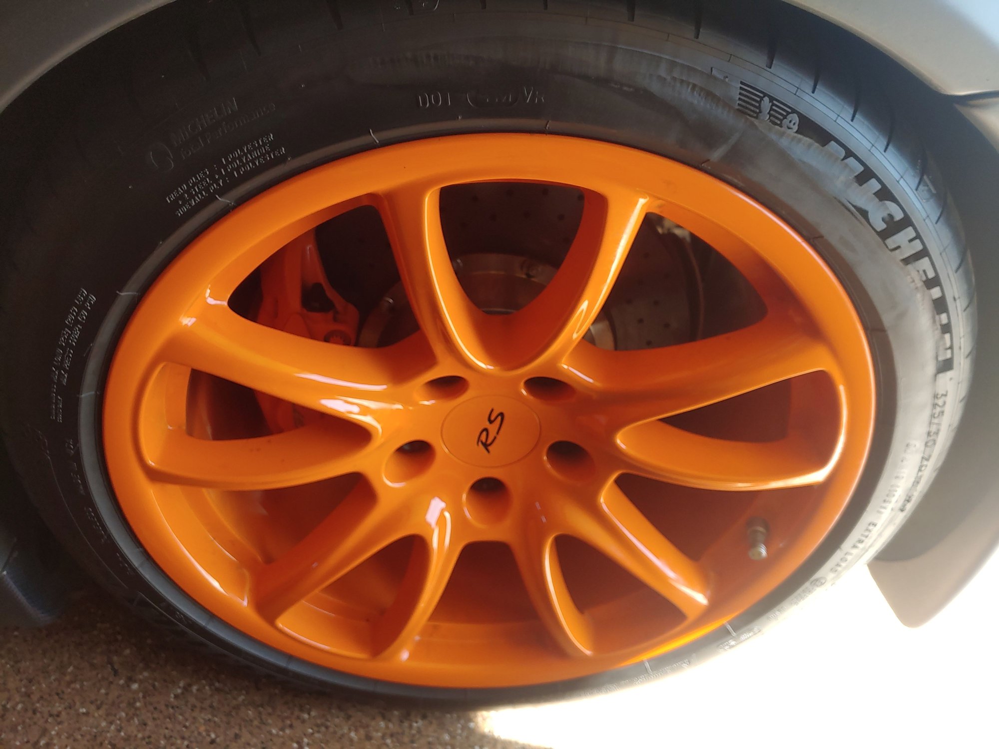

Thanks guys for your input. There is no rubbing on the fender well since this is wide fender by Techart. The other side is ok. All 3 tires are ok. This 4th tire (rear driver) is the tire that was back ordered and delayed in shipment. I had to wait all day at tire shop since Fed Ex said out for delivery. They never showed up which I ended up driving the car home with a used tire on the 4th wheel. Next day the tire showed up, they mounted it I drove it straight home. This is a big shop in Newport Beach called Grand Prix Performance.

They should contact Michelin or whoever bought the tires and get it covered under warranty.
How is it possible you ran over something without those little nibs right below the scallop shaving not be cut up?
I seen all kinds of tire damage over my 40 years of driving and I have never seen something like that caused by driving on a tire. Those cuts are too smooth and scalloped to have been caused by a curb or almost anything else that might have contacted it by driving. The rubber should be shredded not smoothly shaven down. Even the shape of the cuts tells you the tires or item that caused the cuts were moving against each cut, with one overlapping the other at a different angle. How would you have done that?
This is either a shipping or manufacturer defect. The fact that you had to wait for that specific tire due to backorder tells you something as well.

That definitely loos like it sat on a conveyor for 10-15min, just burning away...what's most disappointing is that the rocket scientist that mounted it didn't
"notice".

The original shop should have been able to identify this was not your driving, the scalloping and the juxtaposing directions of the cuts is not normal driving damage and unless you got out there with a cheese scraper or something, there is no way you caused it.
The DOT numbering is unexpected, based on the differing ship times, but maybe they got it from another supplier who took shipment from Michelin off the same batch.
