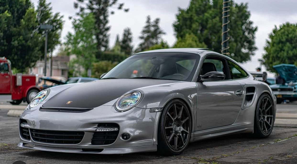

A little off-topic but close you can always do some mods to your Turbo bumper, I went with the very rare Oem full one piece carbon fiber GT2RS fenders (not the stick on flares )and OEM carbon fiber GT2RS hood , and customized the turbo bumper to fit ,with the radiator grill cut out on top.The shop had to fabricate the custom side pieces on the bumper to lineup with the Gt2RS side marker lights that stick out to match the fenders , they were able to use a GT3RS part and heat it up and mold it to the turbo bumper shape,.I also added the .2 headlights with some suspension mods to fill out the wheels to the fenders.Some pics with my street wheels Adv.1 & my track set up Dymags, it gives it a real bulldog kinda look from the front ,it's very subtle but when your parked next too another turbo you immediately notice how much more aggressive it looks.Have yet to ever see anyone else do this set up.

That’s an awesome car twturbo, what a beauty
