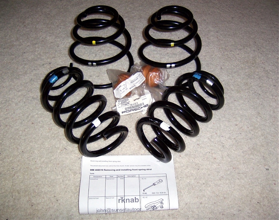

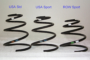

The OEM European springs, also known as Rest of World (RoW) springs are lower by 1-2cm than the U.S. springs depending on "S" or non "S" models. I purchased a matched set for the front and rear from Suncoast in Florida. Very helpful people!
I performed the install myself on my 05 C2 so this is from my experience:
The European springs are shorter and slightly thicker than U.S. OEM springs. The issue with the European springs being shorter, on the assembly the springs remain loose in the struts when the strut caps are installed. Also the provided shorter European rubber bump stop that slips on the U.S. strut shaft fits loose which tells me the European struts have a larger diameter. These may be minor issues, however I am very particular... so I decided against the install, revert back to stock and buy a new C4S.

The OEM European springs, also known as Rest of World (RoW) springs are lower by 1-2cm than the U.S. springs. I purchased a matched set for the front and rear from Suncoast in Florida. Very helpful people!
I performed the install myself on my 05 C2 with no issues. Just make sure you have proper tools so you don't get injured from stored spring energy.
What I learned:
The European springs are shorter and thicker than U.S. OEM springs. The issue with the European springs being shorter is they remain loose when the strut cap is installed. Also the new provided European rubber bump stop that slips on the U.S. strut shaft is loose which tells me the European struts have a larger diameter. These may be minor issues, however I am very particular about my stuff, so I decided to revert back to stock and buy a new C4S.

What I learned:
