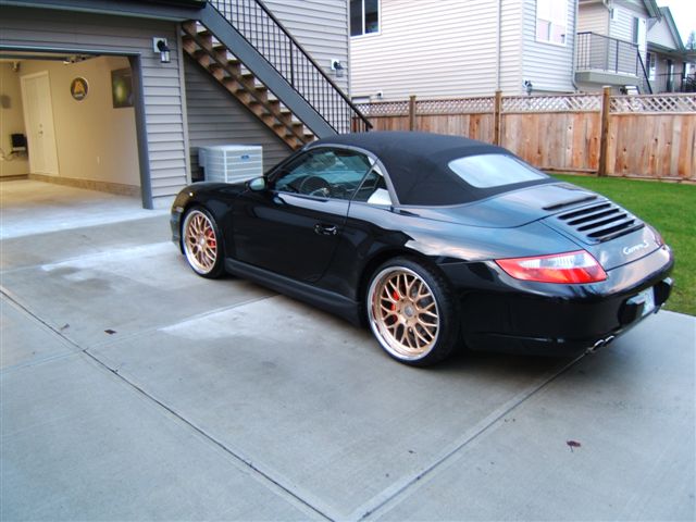

The curve towards the back of the sideskirt has been toned down as well(gave them little more clearance from the ground),
I got the wheels and put them on and found I need to lower the car another inch or so I bought a set of JIC coil-overs(waiting on them right now).
I also made a huge mistake ordering my tires,I ordered 235/30/20 front(which looks great) on the 8.5" rim,however the back 11" rim streeeetched the rear 295/25/20 to the point I absolutely hate it.Now I am in the market for the 305/25/20 which I should have ordered in the first place.
I also got ticked off at the rear spats and ordered a GT3 rear bumper,especially after seeing it on V35's car.
Anyway,here are a few pics of the wheels and please understand that the colour of these wheels is nothing like this in person.It is so hard to see the true colour of these.
