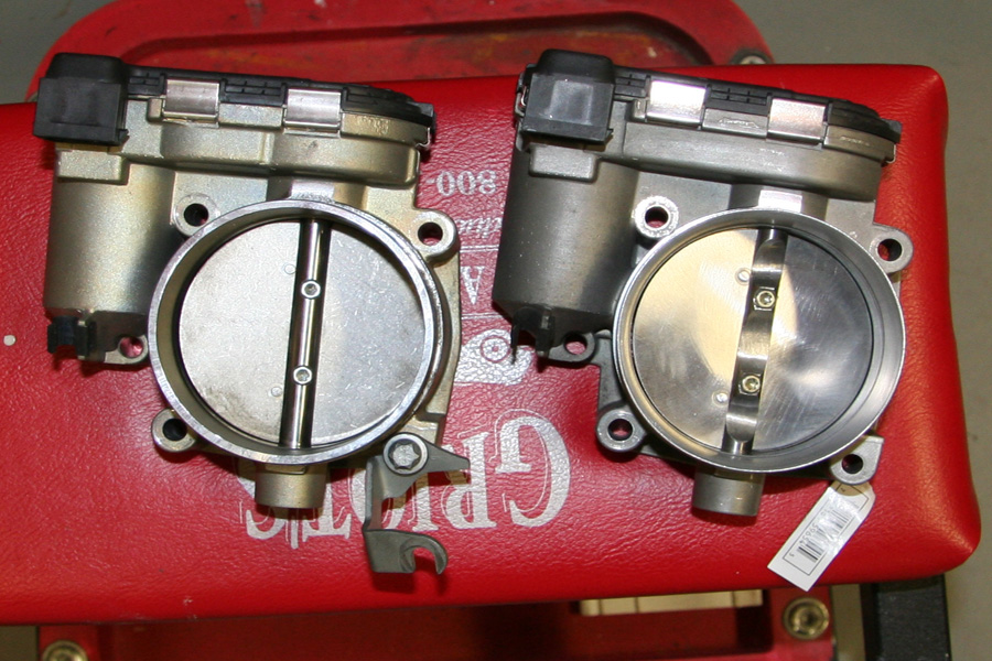

There is a size difference. I am 99% positive it can't be done because I tried. Even if it would bolt on the Bore of the TB and The Plenum are the same size. The Bore on the X-51 TB is larger by 6-8mm so that would not match the Plenum bore of the Stock Plenum or the RSS plenum.
The folks at RSS felt their Plenum and modified TB provided the same or more benefit as the X51 intake and its increased size. One thing to remember I don't think the inlet size at the head is any different, they use the same gasket regardless of intake.
Attached is a picture of my Modified TB. Stock is on the left.
David

Ian.
Did you buy that TB modified, or did you do it yourself.
I see the plates are cutout, I guess that can only help airflow.
Does anyone know if the x51 headers can be added without dropping the engine?

Hi Simon - it's dndodd who has the throttle body. I've no experience of this product.

x51 headers is a one hour job and accessed under the car. The intake manifold is a different story.......
