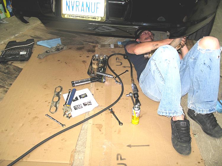

That was my problem I was using ramps and it's really tight. I had to keep my head tilted to the side a little. If you have comfortable work space you'll be fine.

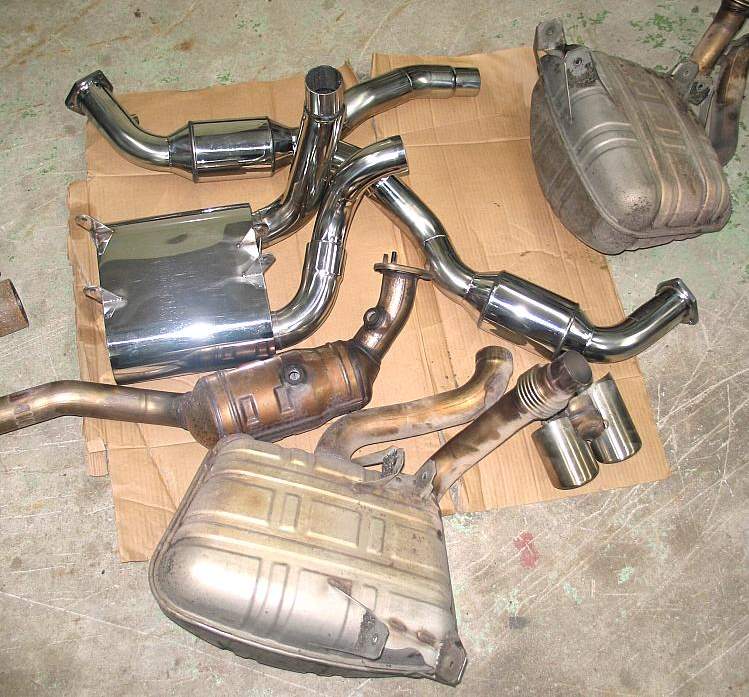

I'm not that mechanically inclined, but I put in a Fabspeed with a friend. It's a tight fit, but did it with jack stands. Took about 45 min. to an hour for us to remove and install. The tips, though, didn't fit and I needed to have them cut by a shop.

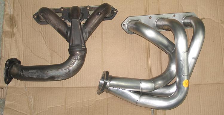

I uninstalled the OEM muffler, installed my X51 headers, AWE cats and mufflers under 3.5hrs. This was with the car on ramps..The 911 has to be the easiest car I ever installed a full exhaust on. My E46 M3 was whole weekend.

if you remove exhaust manifolds 1st, it's rediculously easy.
13mm ratchet.

It is pretty straight forward once you're under the car. If you've never put the car on stands or ramps before, just take your time to ensure everything is stable before you begin work.

...take the rear tires off it will make the job easier.

it took about 1.5-2 hrs max. not too hard. i used a ramp but if you have jack stands, you can remove the wheels which will make it a little easier.
