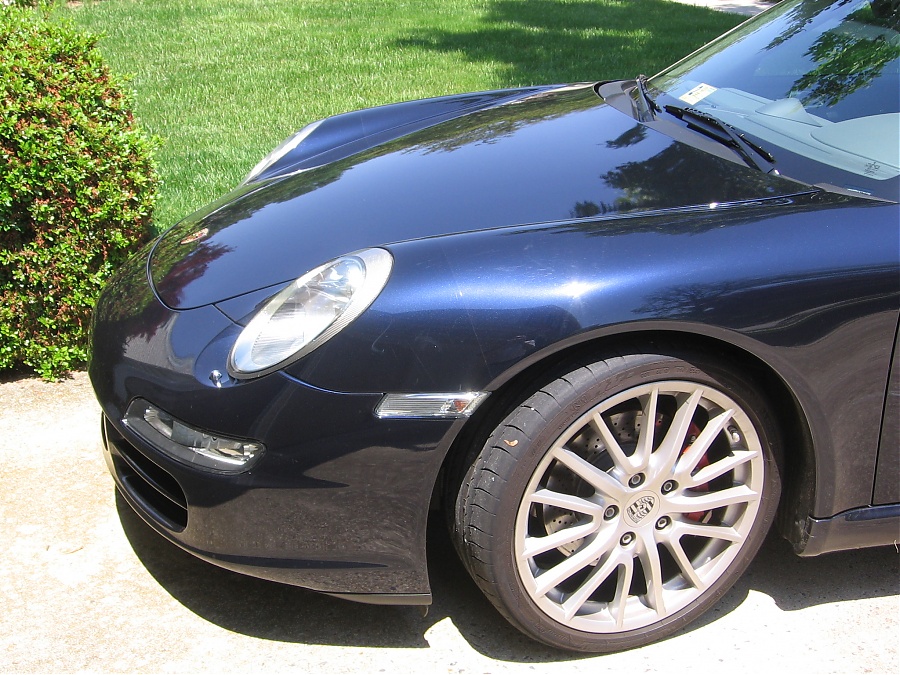

I Have Them
Originally Posted by Motilev
Hi to All.
A have a 997 C2S. My friend buy PCCB for his TT.
Can I install his old brakes to my C2S?
Thanx!
My 2006 C2S is a CPO car. The original owner had PCCB's but he didn't like them so the dealership replaced them with brakes from the Turbo.
The dealership told me that "the Turbo brakes are larger, they use a 6 piston caliper with 42% more pad area. The rotors cool more also about 14% more, actual better than the ceramics... just not as light."
I've had the car at the track several times now and the brakes are awesome.
I would have preferred the PCCB's, but they just weren't available.
To accommodate the larger brakes the car needs these rims:
Mr. B
Thanx for reply!
Rims are nessasary? You think TT brakes will not work with 19 inch Carrera S "Lobsters"?
I think I will upgrade my car during winter. Lightweight rims, Pss10, swaybars, rollcage and GT3 seats, carbonfiber doors, fenders, bumbers and SC kit for more power and torque So I need better brakes
I don't know the answer. I assumed that the dealership that installed the Turbo brakes put those rims on because they were the only ones that would fit but, as I said, that is an assumption on my part. FWIW, the rims are nice, they're just a b*tch to keep clean.
