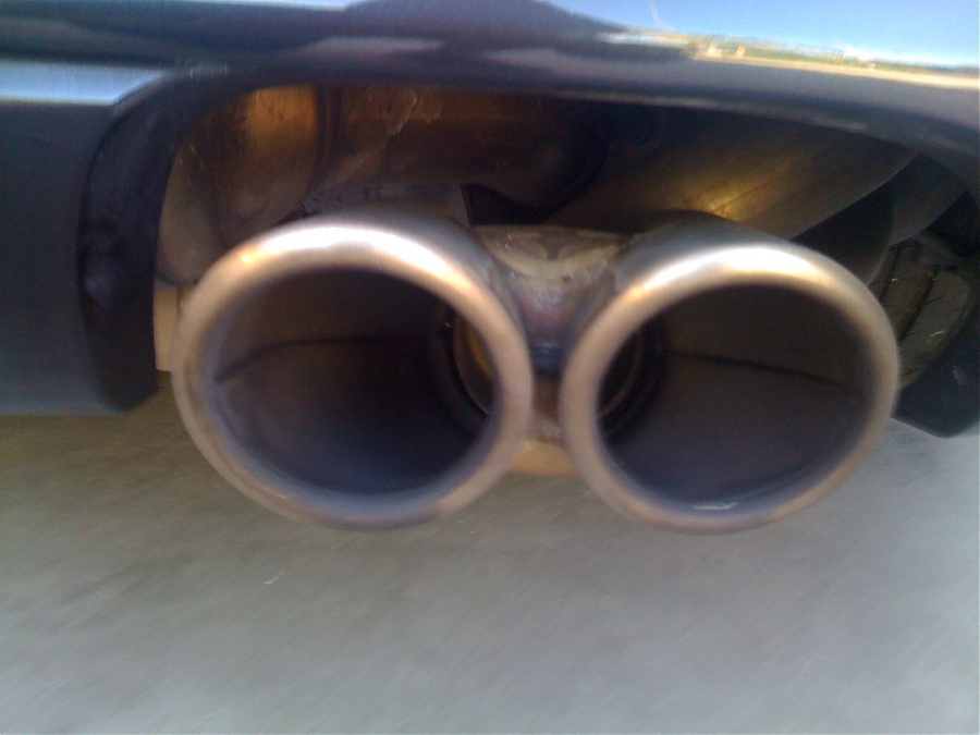

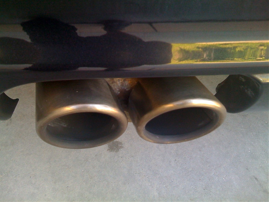

Hey guys, just got a used 997 C2S with 33k miles on it. I love everything about the car, but the only thing that bugs me is that the exhaust tips are no longer the brushed silver that they originally were, but a brown-ish rusty color. Is there any way to clean that off? Thanks in advance!

I used steel wool and it worked pretty well...

Most everything needs to be cleaned once in a while. use some chrome polish / silver polish etc.
If you can't deal with the dullish look, order up some chrome ones - they do look MUCH better.

That's simple. You can use P21S wheel cleaner with OOOO steel wool. You'll then need zymol Metall to give the tips their final polish. We do this on all are higher-end details. Here are links to our site for the two product recommendation:
http://www.glisteningperfectionstore...-Kit%2C/Detail
http://www.glisteningperfectionstore...lish%2C/Detail
Here are the steps:
1. Wash the tips or wipe them down with a microfiber towel
2. Spray p21s wheel cleaner inside and around tips
3. Use a small piece of steel wool, with gloves, and begin rubbing the cleaner into the tips
4. Once you know you've cleaned the area well, wipe it off with a microfiber cloth. Repeat if necessary
5. Once the tips are clean and all the carbon deposits are removed from the inside, wipe down tips with clean microfiber that's damp with water
6. Polish with Zymol Metall, let sit for about 5 minutes, then wipe off Metall with clean microfiber towel
7. Post before and after pics on 6speed
Hope this helps.

It doesn't take more than 5-10 minutes each side. As for them lasting, just maintain polishing using Metall every other month. Just remember to wipe them down after each time you wash the car and you'll never see them that bad again.
