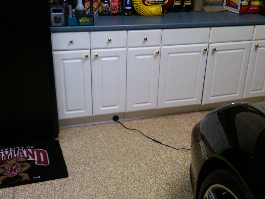

Yup, used Battery Tender Plus for all my cars/motorcycles and wouldn't use anything else. Went a step further and installed a Powerlet socket into lower bumper area to just plug in and avoid closing the door on the wire when using the cig lighter or keeping frunk hood open (both of which work well for most but just an alternative)
