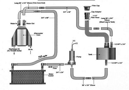

Had a problem tonight with the flow of the coolant through the IC system.
I found that the flow of the coolant would 'spit' out the purge tank which signify wrong direction for flow!
I followed the instructions to a 'T' and read them 100 times today,LOL.
So I enquired with a few knowledgeable people here on the forum which ALL concluded that there may be a mistake with the directions.
I will conatct VF tomorrow and see what they have to say and double check the findings and see if possibly VF made a mistake with the directions.
If so I will modify the appropriate hoses tomorrow...easy fix!
Stacy

Maybe this will help.
Stacy
OK here goes...!
I changed the lines over today....filled the purge tank and started to bleed the system.It seemed to be getting close,when all of a sudden it shot me in the face,LOL!
Ended up that VF had the right lay-out in the first place(how dare I question the instructions).
This is one of those moments that I embarassed myself on the forums!
So I want to thank 1999porsche911,IAPorscheDoc and Redridge for dealing with my countless pm's last night!
Sorry guys....panic set-in!
You guys are always right and I am....well......aaaahhhhhh you know!?
Anyway,IC system has been bled.
But not without wasting a ton of coolant on my garage floor!
You think the floors bad,you should see my clothes.
Man does that pump move the coolant!!
Thanks for the diagram.
ECU OUT tomorrow...for sure!
Stacy
