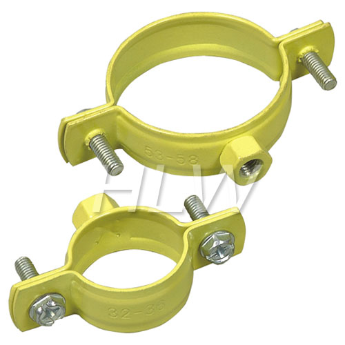

Hey Stacy,
Would something like this work:http://www.stainlessclamp.com/fittin...lasticcoat.htm
It looks like these clamps could be joined side by side.

That is a good find but there may be some play in those or they may not quite be 'JUST' the right size to work,which may cause chafing.
The ones we have made are to exact specs of the hoses.(both factory coolant lines and IC lines).
Too me nothing better than built to suit.
Once you see them bolted in I think you will approve!
That makes these clamps Porsche specific,LOL,something that this car definately deserves,IMO!
And they really aren't that expensive to make,when your friend has a few C&C's !
I have spent a ton of money to buy the charger and mod my car,at this point I decided not to cut a corner.
I am sure that the ty-straps would work but I am even more positive that these clamps WILL!
