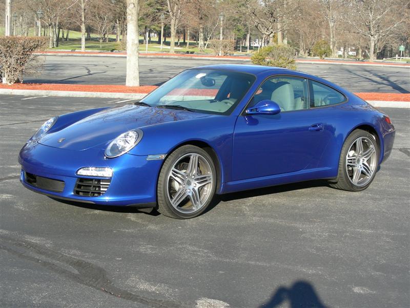

Pretty easy to do, the owner's manual tells you how. Eric @ BumperPlugs is the right guy to get them from. This is what mine looks like with them....
