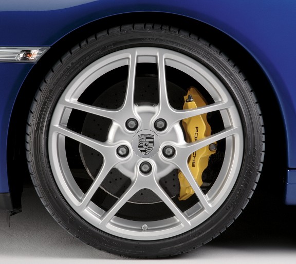

What amazes me is that for decades 17s were "big" and 18s were unusually large. Now there are those that think 19s look downright small? Take a look at these 19s over huge PCCB rotors and calipers. A 20" wheel would make those brakes look tiny. To each his own...
