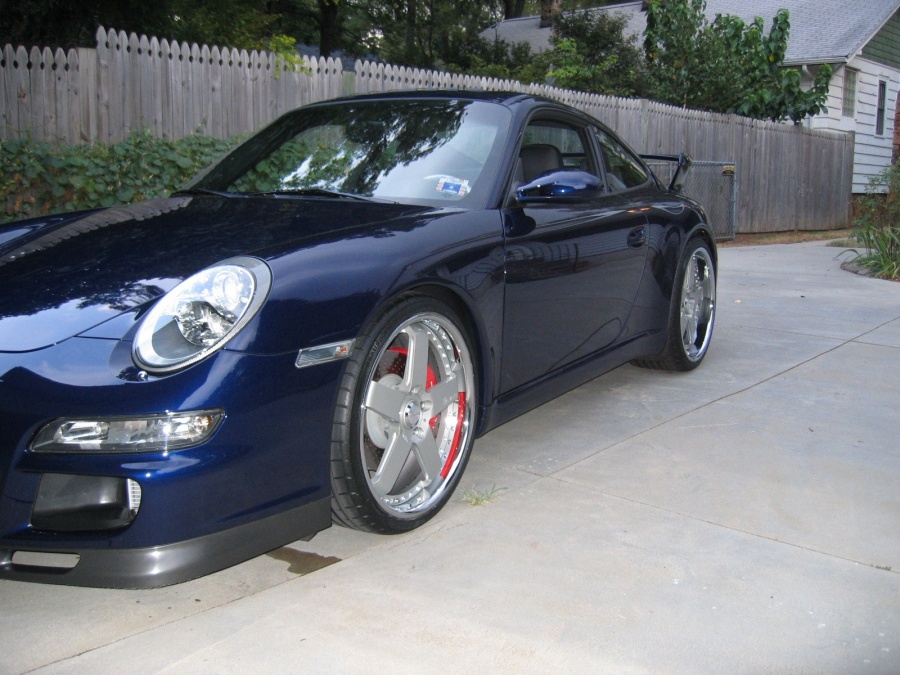

Here is a couple pics of my old C2S with avus501 11x20 rears in 50mm off set.. For anybody who says it won't work. As you can see they don't stick out and didn't rub any.... By the way they are for sale.

nice, can you tell me the offset and width of the front wheels?
Thanks. The fronts are 8.5 with offset of 50mm also..

I know you made your decision already but for reference for those that want more proof:
19x11 +51 offset
295/30/19

Very nice car
