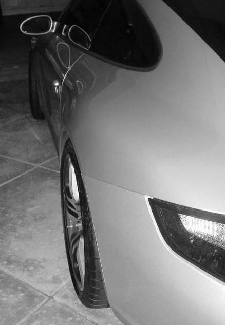

I agree, most of these responses are thoughtless or factually incorrect. The pic attached is a narrow body car like yours with the widebody offset wheels (11" with 51mm)
As you can see, when the car is lowered they tuck in quite nicely. Your car has the highest ride height of any 997 since it is a 3.6 non PASM chassis. The extra height exagerates the impression that the wheels are too far displaced. You can definitely make the wheels work either by lowering the car or maybe just a more aggresive alignment (more neg camber)
The price you paid BTW is very fair for true new car takeoffs with tires. Many of the wheel packages on ebay are BS. Either not true takeoffs or damgaged, etc.
Enjoy your new car and wheels and don't take these message boards too seriously.
dr
+1
I'm running the same offset with 315's. I've tracked my car with this setup, no safety issues what so ever. The car handles so much better over stock. Lower the car (on coilovers if you can) and you'll see how nice the wheels tuck.

The wheels will tuck away perfectly once the vehicle is lowered. We have put OEM 997 widebody wheels on a narrow body applications before and they tend to stick a a few mm's until the car is lowered. Once the suspension is installed the wheels with sit perfectly in your wheel well.
Congrats on the wheels and good-luck with the new car.

They are 19x11J 51mm offset. I've seen several members who put on 15mm spacers on the rears for their nb cars and at least from the pictures, their rears don't seem to stick out as much as mine does. Why is that? If you put 15mm on nb, it makes 52mm, which is close enough to my rears, 51mm. I don't get it why my rears look like buggy.....
You nailed it right there. Your offset is only 1mm more than what lots of people think looks great. As others have pointed out it is the height of the non-PASM suspension that makes it look odd. 52mm is the most common aftermarket wheel offset for the narow body cars. Technically your set-up without spacers could be seen as even 'safer' than using 15mm spacers on NB wheels (mechanically speaking) - not that there is any issue with spacers.
Keep the wheels & tires and go the next step of a decent coil-over kit (Bilstein PSS10 or KWv3 or ...) and then see how you like it. I am certain you will be pleased.

BTW, maybe it is just the pictures i took. Tonight i will try to take another pic. A direct view from the back and not from an angle.

Sounds like the advice is clear - lower the car with Bilsteins or H&R coils and you should be fine...if it rubs then you sell the rears and buy the proper fitment. Good luck!
